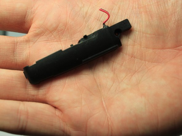

  3. HP Slate 7 Extreme 4400US Top Speaker Replacement: crwdns2935265:03crwdnd2935265:01crwdnd2935265:03crwdne2935265:0 HP Slate 7 Extreme 4400US Top Speaker Replacement: crwdns2935265:03crwdnd2935265:02crwdnd2935265:03crwdne2935265:0 HP Slate 7 Extreme 4400US Top Speaker Replacement: crwdns2935265:03crwdnd2935265:03crwdnd2935265:03crwdne2935265:0
    • Gently pull the entire black housing away from device.
    • Locate where the speakers' wires are connected to the motherboard.
    • Using wire cutters, sever the wires connecting the speaker to the motherboard. Strip the wires with a wire stripper and fashion the new wires to the old ones connected to the motherboard to reconnect.
    • You may use a soldering tool to disconnect the wires from the motherboard and to reconnect the new wires back to the motherboard.
