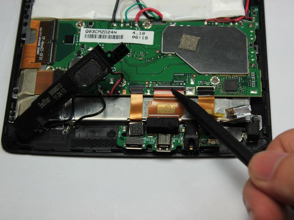

  2. HP Slate 7 Extreme 4400US Motherboard  Replacement, Front-facing Camera: crwdns2935265:02crwdnd2935265:01crwdnd2935265:02crwdne2935265:0 HP Slate 7 Extreme 4400US Motherboard  Replacement, Front-facing Camera: crwdns2935265:02crwdnd2935265:02crwdnd2935265:02crwdne2935265:0
    • Use the PH #000 screw bit to remove the 5.0 mm screw holding down the top speaker to expose the front-facing camera.
  3. HP Slate 7 Extreme 4400US Motherboard  Replacement: crwdns2935265:03crwdnd2935265:01crwdnd2935265:03crwdne2935265:0 HP Slate 7 Extreme 4400US Motherboard  Replacement: crwdns2935265:03crwdnd2935265:02crwdnd2935265:03crwdne2935265:0 HP Slate 7 Extreme 4400US Motherboard  Replacement: crwdns2935265:03crwdnd2935265:03crwdnd2935265:03crwdne2935265:0
    • Pull back the tape holding the the front facing camera's connector strip to the device.
    • Use the nylon spudger to flip up the black retaining flap of the zero insertion force (ZIF) connector holding the strip in place.
    • Gently pull the camera's connecting strip out from the port.

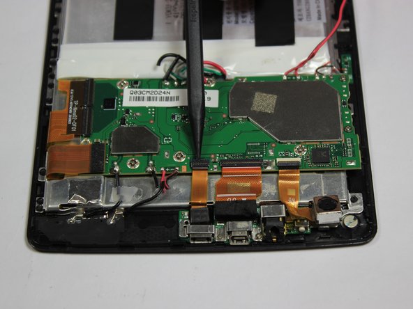

  6. HP Slate 7 Extreme 4400US Motherboard  Replacement, Charging port and Audio Jack Circuit Board: crwdns2935265:06crwdnd2935265:01crwdnd2935265:02crwdne2935265:0 HP Slate 7 Extreme 4400US Motherboard  Replacement, Charging port and Audio Jack Circuit Board: crwdns2935265:06crwdnd2935265:02crwdnd2935265:02crwdne2935265:0
    • Use the PH #000 phillips head screw driver to remove one 5.0 mm screw.
    • Move plastic housing and rear facing camera to expose silver bracket.

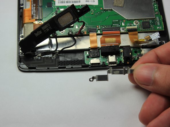

  7. HP Slate 7 Extreme 4400US Motherboard  Replacement: crwdns2935265:07crwdnd2935265:01crwdnd2935265:02crwdne2935265:0 HP Slate 7 Extreme 4400US Motherboard  Replacement: crwdns2935265:07crwdnd2935265:02crwdnd2935265:02crwdne2935265:0
    • Use the PH #000 phillips head screw driver to remove three 3.0mm screws. Remove the silver bracket.
  8. HP Slate 7 Extreme 4400US Motherboard  Replacement: crwdns2935265:08crwdnd2935265:01crwdnd2935265:03crwdne2935265:0 HP Slate 7 Extreme 4400US Motherboard  Replacement: crwdns2935265:08crwdnd2935265:02crwdnd2935265:03crwdne2935265:0 HP Slate 7 Extreme 4400US Motherboard  Replacement: crwdns2935265:08crwdnd2935265:03crwdnd2935265:03crwdne2935265:0
    • Grab the green circuit board and pull directly up to separate the glued down power strip.
    • Gently pull the circuit board out of its connector.
  9. HP Slate 7 Extreme 4400US Motherboard  Replacement, Top Speaker: crwdns2935265:09crwdnd2935265:01crwdnd2935265:02crwdne2935265:0 HP Slate 7 Extreme 4400US Motherboard  Replacement, Top Speaker: crwdns2935265:09crwdnd2935265:02crwdnd2935265:02crwdne2935265:0
    • Use the PH #000 phillips screw bit to remove one 5.0 mm screw.

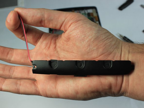

  10. HP Slate 7 Extreme 4400US Motherboard  Replacement: crwdns2935265:010crwdnd2935265:01crwdnd2935265:03crwdne2935265:0 HP Slate 7 Extreme 4400US Motherboard  Replacement: crwdns2935265:010crwdnd2935265:02crwdnd2935265:03crwdne2935265:0 HP Slate 7 Extreme 4400US Motherboard  Replacement: crwdns2935265:010crwdnd2935265:03crwdnd2935265:03crwdne2935265:0
    • Gently pull the entire black housing away from device.
    • Locate where the speakers' wires are connected to the motherboard.
    • Using wire cutters, sever the wires connecting the speaker to the motherboard. Strip the wires with a wire stripper and fashion the new wires to the old ones connected to the motherboard to reconnect.
    • You may use a soldering tool to disconnect the wires from the motherboard and to reconnect the new wires back to the motherboard.

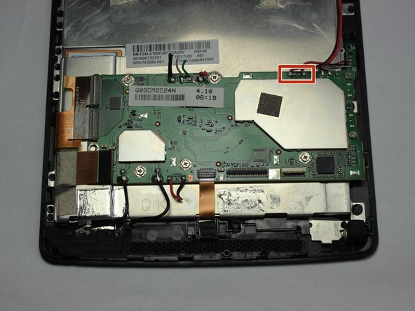

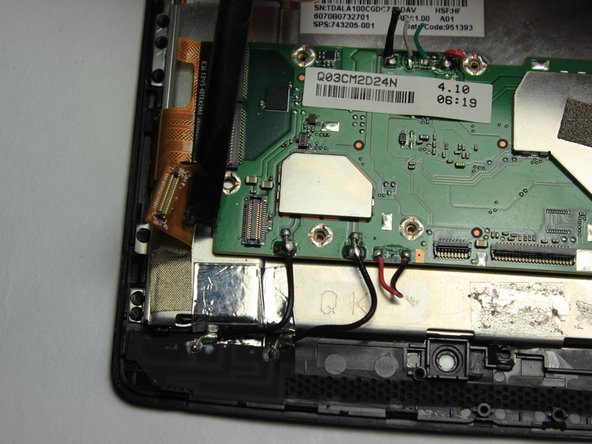

  13. HP Slate 7 Extreme 4400US Motherboard  Replacement, Motherboard: crwdns2935265:013crwdnd2935265:01crwdnd2935265:01crwdne2935265:0
    • Using the PH #000 philips head screw bit, unscrew the seven screws holding the motherboard in place. Those in red are 3.0mm in length
    • Those in orange are 5.0 mm in length

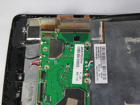

  14. HP Slate 7 Extreme 4400US Motherboard  Replacement: crwdns2935265:014crwdnd2935265:01crwdnd2935265:02crwdne2935265:0 HP Slate 7 Extreme 4400US Motherboard  Replacement: crwdns2935265:014crwdnd2935265:02crwdnd2935265:02crwdne2935265:0
    • Disconnect the press-fit connector from the mother board using the nylon spudger. Gently pry the connector up; it will pop out of place easily, so if its not coming out don't force it.

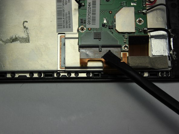

  15. HP Slate 7 Extreme 4400US Motherboard  Replacement: crwdns2935265:015crwdnd2935265:01crwdnd2935265:03crwdne2935265:0 HP Slate 7 Extreme 4400US Motherboard  Replacement: crwdns2935265:015crwdnd2935265:02crwdnd2935265:03crwdne2935265:0 HP Slate 7 Extreme 4400US Motherboard  Replacement: crwdns2935265:015crwdnd2935265:03crwdnd2935265:03crwdne2935265:0
    • Gently pull the connector strips out of the motherboard. The motherboard is now disconnected.
