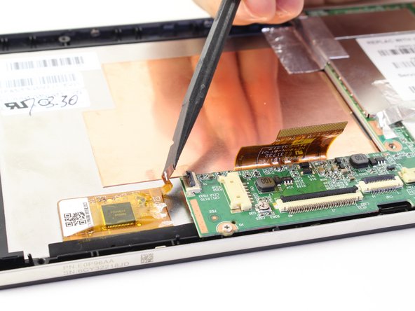

  13. HP Slate 7 4601 Motherboard Replacement, Motherboard: crwdns2935265:013crwdnd2935265:01crwdnd2935265:02crwdne2935265:0 HP Slate 7 4601 Motherboard Replacement, Motherboard: crwdns2935265:013crwdnd2935265:02crwdnd2935265:02crwdne2935265:0

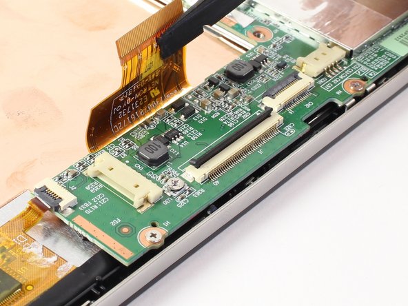

    • Disconnect the LCD screen ribbon by lifting up the black panel with the flat end of a spudger and sliding the gold strip out.
    • When reconnecting the LCD connector ribbon, make sure that it's pushed in all the way. If it isn't, there will be horizontal lines when you power the tablet on.
  14. HP Slate 7 4601 Motherboard Replacement: crwdns2935265:014crwdnd2935265:01crwdnd2935265:02crwdne2935265:0 HP Slate 7 4601 Motherboard Replacement: crwdns2935265:014crwdnd2935265:02crwdnd2935265:02crwdne2935265:0
    • Likewise, disconnect the square radio chip ribbon by lifting up the black panel with a spudger and sliding the gold strip out.

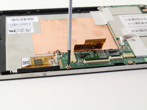

  15. HP Slate 7 4601 Motherboard Replacement: crwdns2935265:015crwdnd2935265:01crwdnd2935265:02crwdne2935265:0 HP Slate 7 4601 Motherboard Replacement: crwdns2935265:015crwdnd2935265:02crwdnd2935265:02crwdne2935265:0
    • You will be using a #00 Phillips Head screwdriver to free the motherboard.
    • Remove the six 1.75mm x 3mm Phillips Head screws holding the motherboard to the screen.

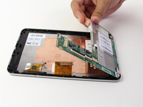

  16. HP Slate 7 4601 Motherboard Replacement: crwdns2935265:016crwdnd2935265:01crwdnd2935265:02crwdne2935265:0 HP Slate 7 4601 Motherboard Replacement: crwdns2935265:016crwdnd2935265:02crwdnd2935265:02crwdne2935265:0
    • Using your hand, lift up the silver tape from the copper plate.
    • Lift the motherboard out of the device.
    • You may need to wiggle and work the motherboard to get it released from the device
