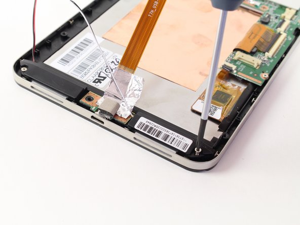

  13. HP Slate 7 4601 Charging Port Replacement, Charging Port: crwdns2935265:013crwdnd2935265:01crwdnd2935265:02crwdne2935265:0 HP Slate 7 4601 Charging Port Replacement, Charging Port: crwdns2935265:013crwdnd2935265:02crwdnd2935265:02crwdne2935265:0
    • To free the speaker assembly, you will need a #00 Phillips Head screwdriver.
    • Remove the two 1.75mm x 3mm Phillips Head screws from the speaker assembly.

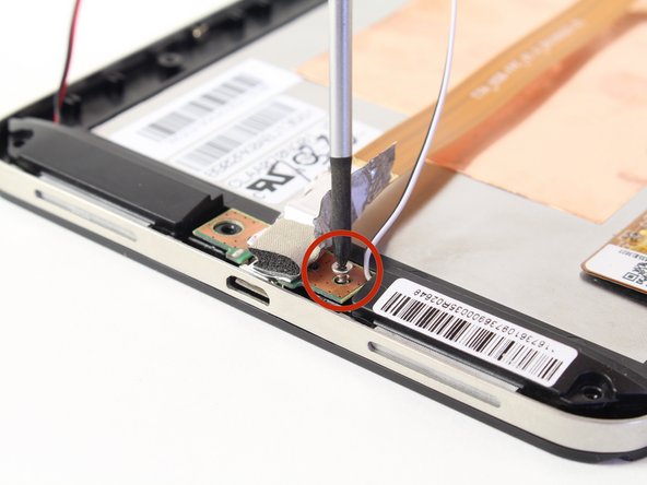

  14. HP Slate 7 4601 Charging Port Replacement: crwdns2935265:014crwdnd2935265:01crwdnd2935265:02crwdne2935265:0 HP Slate 7 4601 Charging Port Replacement: crwdns2935265:014crwdnd2935265:02crwdnd2935265:02crwdne2935265:0
    • Pull back the foil overlapping the charging port to reveal another 1.75mm x 3mm Phillips Head screw.
    • Remove the screw with a #00 Phillips Head screwdriver.

where do you get the replacement parts for charging port
Scott Winstone - crwdns2934203:0crwdne2934203:0
Since HP does not supply the replacement ribbon, or many other parts for that matter, it is easiest to search on eBay and/or Craigslist for the parts needed. I found that the UK version of Amazon and eBay offer the best availability for such parts.
