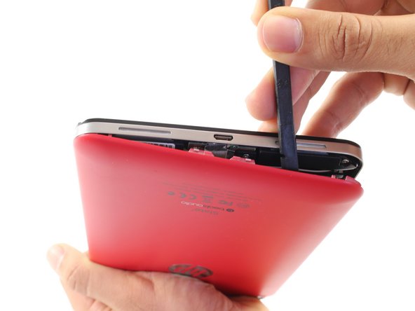

    • Begin your replacement by using a T3 or T4 Torx screwdriver.
    • Remove the two 1.4mm x 3mm Torx Head screws at the top of the device.
  2. HP Slate 7 4601 Battery Replacement: crwdns2935265:02crwdnd2935265:01crwdnd2935265:02crwdne2935265:0 HP Slate 7 4601 Battery Replacement: crwdns2935265:02crwdnd2935265:02crwdnd2935265:02crwdne2935265:0
    • With the pointed end of the spudger, remove the thin metal band.
    • It is easiest to remove the metal band through the headphone opening.
  3. HP Slate 7 4601 Battery Replacement: crwdns2935265:03crwdnd2935265:01crwdnd2935265:02crwdne2935265:0 HP Slate 7 4601 Battery Replacement: crwdns2935265:03crwdnd2935265:02crwdnd2935265:02crwdne2935265:0
    • Using the flat end of the spudger, pry back the rear plastic cover.
    • As you work your way around the edge, several "pop" noises will be made. These noises are caused by the plastic clips coming undone.
