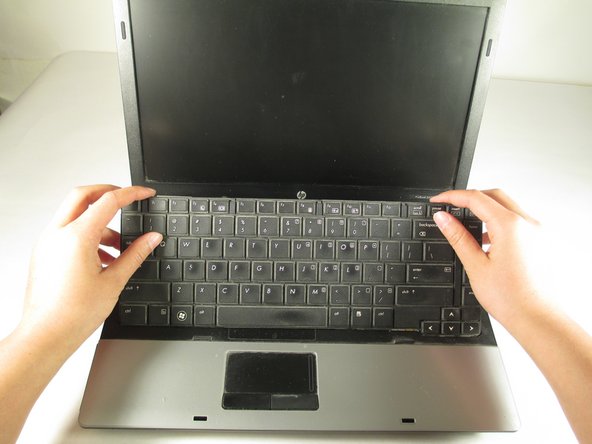

    • Flip the laptop right side up and open the screen.
    • Locate the 4 keyboard tabs. Slide the tabs towards you.
  7. HP Probook 6450b Fan Cleaning & Thermal Paste Replacement: crwdns2935265:07crwdnd2935265:01crwdnd2935265:03crwdne2935265:0 HP Probook 6450b Fan Cleaning & Thermal Paste Replacement: crwdns2935265:07crwdnd2935265:02crwdnd2935265:03crwdne2935265:0 HP Probook 6450b Fan Cleaning & Thermal Paste Replacement: crwdns2935265:07crwdnd2935265:03crwdnd2935265:03crwdne2935265:0
    • Lift the keyboard by the upper edge, then flip it over so the ribbon cable is exposed.
    • Do not attempt to remove the keyboard until the ribbon cable has been disconnected.

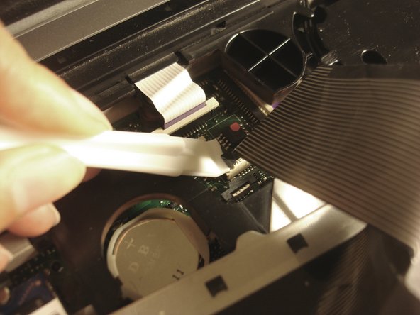

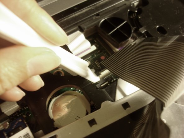

  8. HP Probook 6450b Fan Cleaning & Thermal Paste Replacement: crwdns2935265:08crwdnd2935265:01crwdnd2935265:03crwdne2935265:0 HP Probook 6450b Fan Cleaning & Thermal Paste Replacement: crwdns2935265:08crwdnd2935265:02crwdnd2935265:03crwdne2935265:0 HP Probook 6450b Fan Cleaning & Thermal Paste Replacement: crwdns2935265:08crwdnd2935265:03crwdnd2935265:03crwdne2935265:0
    • Lift both ends of the plastic tab securing the ribbon cable to the system board with the help of a spudger.
    • If you don't have a spudger, any plastic item with a thin edge, like the plastic opening tool pictured here, will work just as well. Guitar picks are also a good alternative.
  9. HP Probook 6450b Fan Cleaning & Thermal Paste Replacement: crwdns2935265:09crwdnd2935265:01crwdnd2935265:01crwdne2935265:0
    • Remove the keyboard ribbon cable and set the keyboard aside.

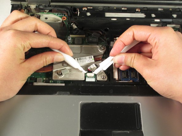

  11. HP Probook 6450b Fan Cleaning & Thermal Paste Replacement: crwdns2935265:011crwdnd2935265:01crwdnd2935265:02crwdne2935265:0 HP Probook 6450b Fan Cleaning & Thermal Paste Replacement: crwdns2935265:011crwdnd2935265:02crwdnd2935265:02crwdne2935265:0
    • Flip the laptop right side up, and open the display.
    • Locate the LED board ribbon cable. Lift both ends of the plastic tab securing the ribbon cable to the system board.
    • Slide out the LED board ribbon cable.

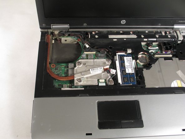

    • Remove the switch cover.
    • You may need to use the spudger or opening tool to pry open the switch cover. It is easiest to start from the top edge, closest to the screen.
  13. HP Probook 6450b Fan Cleaning & Thermal Paste Replacement: crwdns2935265:013crwdnd2935265:01crwdnd2935265:03crwdne2935265:0 HP Probook 6450b Fan Cleaning & Thermal Paste Replacement: crwdns2935265:013crwdnd2935265:02crwdnd2935265:03crwdne2935265:0 HP Probook 6450b Fan Cleaning & Thermal Paste Replacement: crwdns2935265:013crwdnd2935265:03crwdnd2935265:03crwdne2935265:0

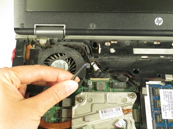

    • Locate and loosen the 2 slotted Torx T8M 2.5 x 7.0 screws securing the fan to the motherboard.
    • Disconnect the fan cable from the board.
  14. HP Probook 6450b Fan Cleaning & Thermal Paste Replacement: crwdns2935265:014crwdnd2935265:01crwdnd2935265:02crwdne2935265:0 HP Probook 6450b Fan Cleaning & Thermal Paste Replacement: crwdns2935265:014crwdnd2935265:02crwdnd2935265:02crwdne2935265:0

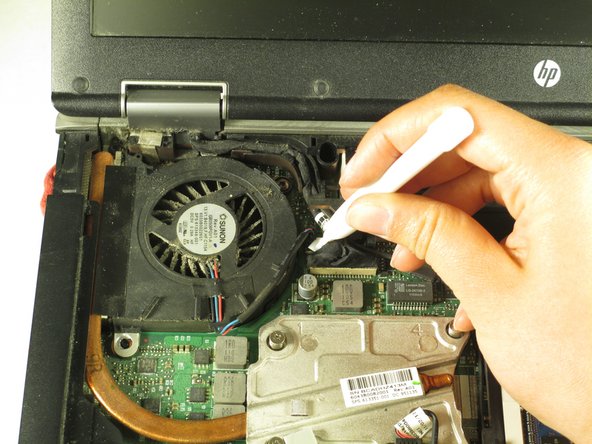

    • Lift out vent fan.
    • Clean the dust from the fan with a small brush and/or compressed air.
    • When using compressed air, avoid tilting the bottle greater than 40 degrees from vertical. Doing so will cause the part and your hand to rapidly cool.
