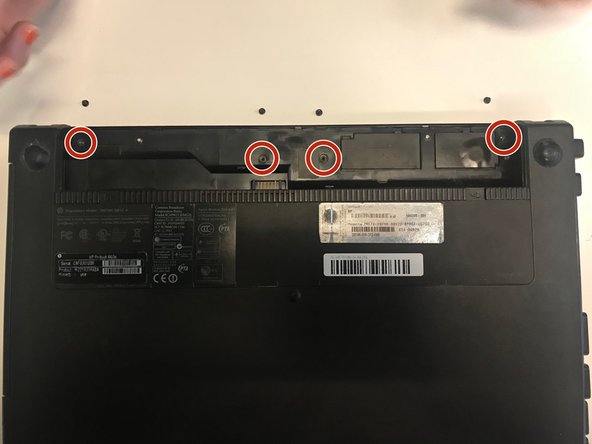

    • Turn off the laptop.
    • Flip over the laptop.
  2. HP Probook 4425s Keyboard Replacement: crwdns2935265:02crwdnd2935265:01crwdnd2935265:01crwdne2935265:0
    • Take out the battery.
  3. HP Probook 4425s Keyboard Replacement: crwdns2935265:03crwdnd2935265:01crwdnd2935265:02crwdne2935265:0 HP Probook 4425s Keyboard Replacement: crwdns2935265:03crwdnd2935265:02crwdnd2935265:02crwdne2935265:0
    • Remove the four 3 mm Phillips head screws that secure the keyboard in place.

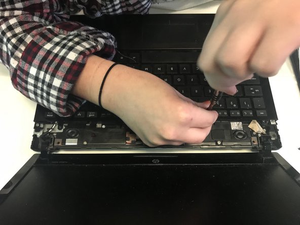

  4. HP Probook 4425s Keyboard Replacement: crwdns2935265:04crwdnd2935265:01crwdnd2935265:03crwdne2935265:0 HP Probook 4425s Keyboard Replacement: crwdns2935265:04crwdnd2935265:02crwdnd2935265:03crwdne2935265:0 HP Probook 4425s Keyboard Replacement: crwdns2935265:04crwdnd2935265:03crwdnd2935265:03crwdne2935265:0

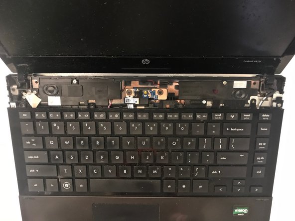

    • Flip over and open the laptop.
    • Remove the now loosened cover by grabbing both sides and sliding up.
    • Remove the four 3mm Phillips head black screws directly above the keyboard.

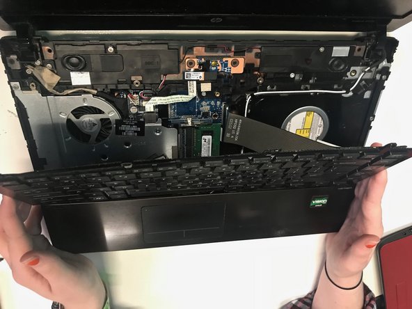

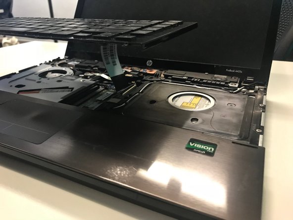

  5. HP Probook 4425s Keyboard Replacement: crwdns2935265:05crwdnd2935265:01crwdnd2935265:03crwdne2935265:0 HP Probook 4425s Keyboard Replacement: crwdns2935265:05crwdnd2935265:02crwdnd2935265:03crwdne2935265:0 HP Probook 4425s Keyboard Replacement: crwdns2935265:05crwdnd2935265:03crwdnd2935265:03crwdne2935265:0
    • Carefully remove the keyboard by sliding it up towards the screen of the computer in order to release the keyboard ribbon cable.
