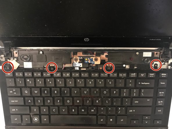

  4. HP Probook 4425s Hard Drive Replacement: crwdns2935265:04crwdnd2935265:01crwdnd2935265:02crwdne2935265:0 HP Probook 4425s Hard Drive Replacement: crwdns2935265:04crwdnd2935265:02crwdnd2935265:02crwdne2935265:0
    • Flip over and open the laptop.
    • Remove the now loosened cover by grabbing both sides and sliding up.
    • Remove the four 3mm Phillips head black screws directly above the keyboard.

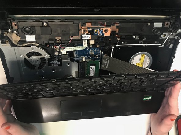

  5. HP Probook 4425s Hard Drive Replacement: crwdns2935265:05crwdnd2935265:01crwdnd2935265:02crwdne2935265:0 HP Probook 4425s Hard Drive Replacement: crwdns2935265:05crwdnd2935265:02crwdnd2935265:02crwdne2935265:0
    • Carefully remove the keyboard by sliding it up towards the screen of the computer in order to release the keyboard ribbon cable.

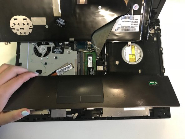

  6. HP Probook 4425s Hard Drive Replacement: crwdns2935265:06crwdnd2935265:01crwdnd2935265:03crwdne2935265:0 HP Probook 4425s Hard Drive Replacement: crwdns2935265:06crwdnd2935265:02crwdnd2935265:03crwdne2935265:0 HP Probook 4425s Hard Drive Replacement: crwdns2935265:06crwdnd2935265:03crwdnd2935265:03crwdne2935265:0
    • Remove the three black 3 mm Phillips head screws from the under the keyboard that are directly above the mouse pad.
    • Carefully remove the mouse pad.

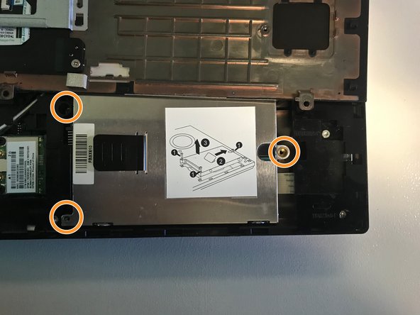

  7. HP Probook 4425s Hard Drive Replacement: crwdns2935265:07crwdnd2935265:01crwdnd2935265:02crwdne2935265:0 HP Probook 4425s Hard Drive Replacement: crwdns2935265:07crwdnd2935265:02crwdnd2935265:02crwdne2935265:0
    • The hard drive should be located on the right side of the laptop under the mouse pad.
    • Remove the two black 2 mm Phillips screws holding the hard drive in place on the left side, and remove the larger Phillips head screw on the right side of the hard drive.

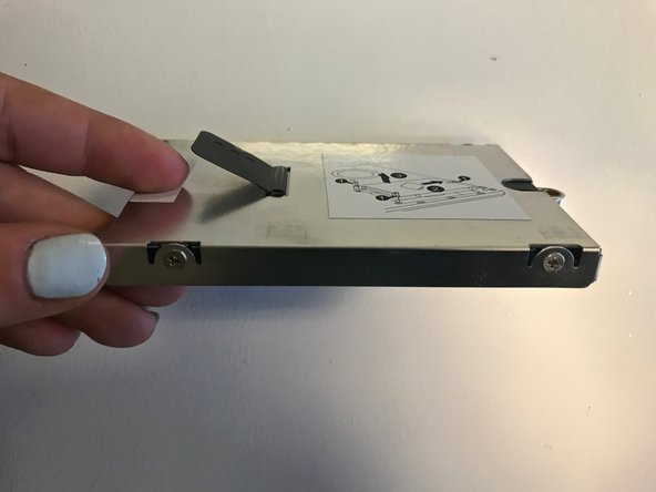

  8. HP Probook 4425s Hard Drive Replacement: crwdns2935265:08crwdnd2935265:01crwdnd2935265:02crwdne2935265:0 HP Probook 4425s Hard Drive Replacement: crwdns2935265:08crwdnd2935265:02crwdnd2935265:02crwdne2935265:0
    • Remove the hard drive.
