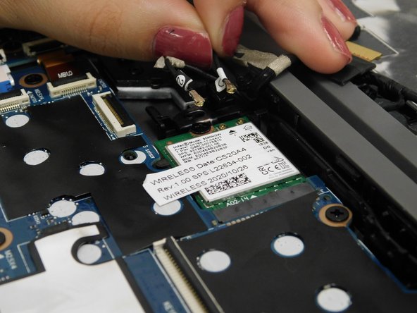

  8. HP ProBook x360 11 G5 EE Wireless Card Replacement, Wireless Card: crwdns2935265:08crwdnd2935265:01crwdnd2935265:03crwdne2935265:0 HP ProBook x360 11 G5 EE Wireless Card Replacement, Wireless Card: crwdns2935265:08crwdnd2935265:02crwdnd2935265:03crwdne2935265:0 HP ProBook x360 11 G5 EE Wireless Card Replacement, Wireless Card: crwdns2935265:08crwdnd2935265:03crwdnd2935265:03crwdne2935265:0
    • Disconnect the ribbon wire from the motherboard by lifting the small flap that holds it in place.
  9. HP ProBook x360 11 G5 EE Wireless Card Replacement: crwdns2935265:09crwdnd2935265:01crwdnd2935265:02crwdne2935265:0 HP ProBook x360 11 G5 EE Wireless Card Replacement: crwdns2935265:09crwdnd2935265:02crwdnd2935265:02crwdne2935265:0
    • Remove both antenna cables that are attached to the wireless card.
  10. HP ProBook x360 11 G5 EE Wireless Card Replacement: crwdns2935265:010crwdnd2935265:01crwdnd2935265:03crwdne2935265:0 HP ProBook x360 11 G5 EE Wireless Card Replacement: crwdns2935265:010crwdnd2935265:02crwdnd2935265:03crwdne2935265:0 HP ProBook x360 11 G5 EE Wireless Card Replacement: crwdns2935265:010crwdnd2935265:03crwdnd2935265:03crwdne2935265:0
    • Remove the 3 mm screw that secures the wireless card using a JIS #0 screwdriver.
    • Slide the wireless card out of the slot gently.
    • Make sure not to pull it directly up as it can break.
