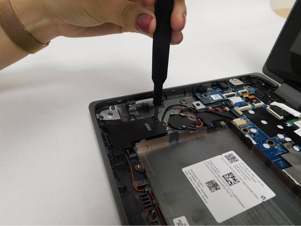

  8. HP ProBook x360 11 G5 EE Speakers Replacement, Speakers: crwdns2935265:08crwdnd2935265:01crwdnd2935265:02crwdne2935265:0 HP ProBook x360 11 G5 EE Speakers Replacement, Speakers: crwdns2935265:08crwdnd2935265:02crwdnd2935265:02crwdne2935265:0
    • Remove the four 5 mm screws holding the speakers in place using a JIS #0 screwdriver.
  9. HP ProBook x360 11 G5 EE Speakers Replacement: crwdns2935265:09crwdnd2935265:01crwdnd2935265:02crwdne2935265:0 HP ProBook x360 11 G5 EE Speakers Replacement: crwdns2935265:09crwdnd2935265:02crwdnd2935265:02crwdne2935265:0
    • Disconnect the speaker wire from its socket on the motherboard.
  10. HP ProBook x360 11 G5 EE Speakers Replacement: crwdns2935265:010crwdnd2935265:01crwdnd2935265:03crwdne2935265:0 HP ProBook x360 11 G5 EE Speakers Replacement: crwdns2935265:010crwdnd2935265:02crwdnd2935265:03crwdne2935265:0 HP ProBook x360 11 G5 EE Speakers Replacement: crwdns2935265:010crwdnd2935265:03crwdnd2935265:03crwdne2935265:0
    • Remove the left speaker gently.
    • Remove the cable that connects both speakers together from the notches that hold it in place. Be careful when pulling the wire to avoid damaging it.
    • Remove the right speaker gently.
