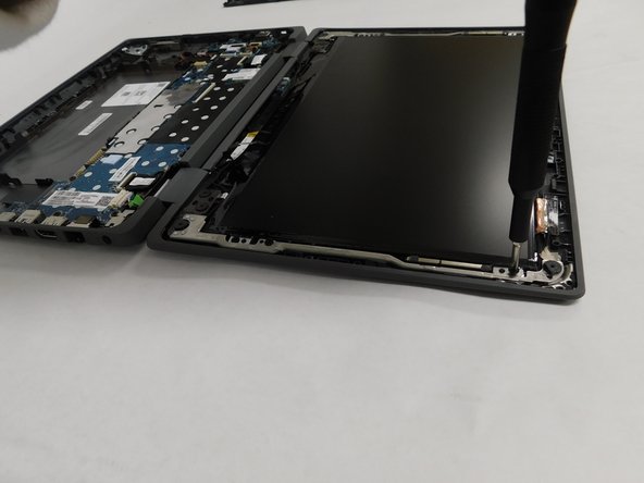

    • Remove the four 2.3 mm screws holding the screen in place with the JIS #0 screwdriver.
  11. HP ProBook x360 11 G5 EE Display Panel Replacement: crwdns2935265:011crwdnd2935265:01crwdnd2935265:03crwdne2935265:0 HP ProBook x360 11 G5 EE Display Panel Replacement: crwdns2935265:011crwdnd2935265:02crwdnd2935265:03crwdne2935265:0 HP ProBook x360 11 G5 EE Display Panel Replacement: crwdns2935265:011crwdnd2935265:03crwdnd2935265:03crwdne2935265:0
    • Lift the screen to disconnect the wire attaching it to the laptop.
    • Remove the display panel from the rest of the laptop.
