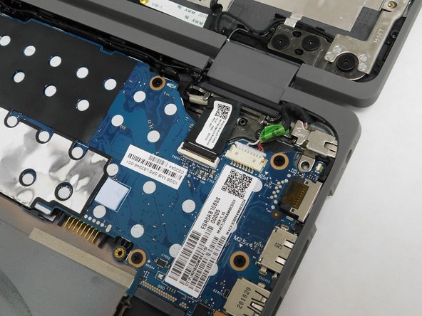

  8. HP ProBook x360 11 G5 EE Charging Port Replacement, Charging Port: crwdns2935265:08crwdnd2935265:01crwdnd2935265:02crwdne2935265:0 HP ProBook x360 11 G5 EE Charging Port Replacement, Charging Port: crwdns2935265:08crwdnd2935265:02crwdnd2935265:02crwdne2935265:0
    • Remove the single 3 mm screw from the charging port using a T5 Torx screwdriver.

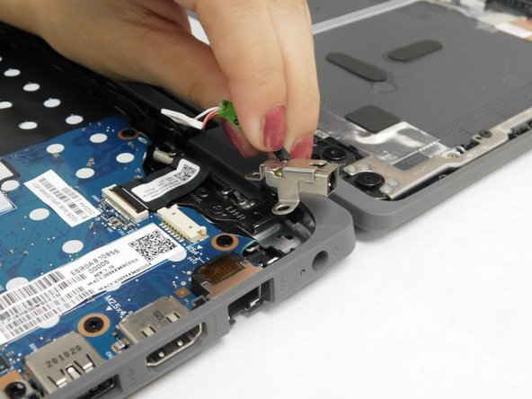

  9. HP ProBook x360 11 G5 EE Charging Port Replacement: crwdns2935265:09crwdnd2935265:01crwdnd2935265:03crwdne2935265:0 HP ProBook x360 11 G5 EE Charging Port Replacement: crwdns2935265:09crwdnd2935265:02crwdnd2935265:03crwdne2935265:0 HP ProBook x360 11 G5 EE Charging Port Replacement: crwdns2935265:09crwdnd2935265:03crwdnd2935265:03crwdne2935265:0
    • Disconnect the charging port wire from the motherboard.
    • Remove the charging port from your device.

I followed each and every step, and realised a little too late that my laptop is a HP ProBook x360 11 G1 -and not a G5. The G1 requires the ability to de-solder the built in charging port.
On step 6, I noticed there were 6 screws holding the battery in, not 4.
Then on step 9, I noticed that the charging port is actually soldered to the motherboard and there is no visible cable attaching it to the board which can be unhooked.
