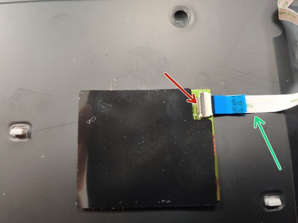

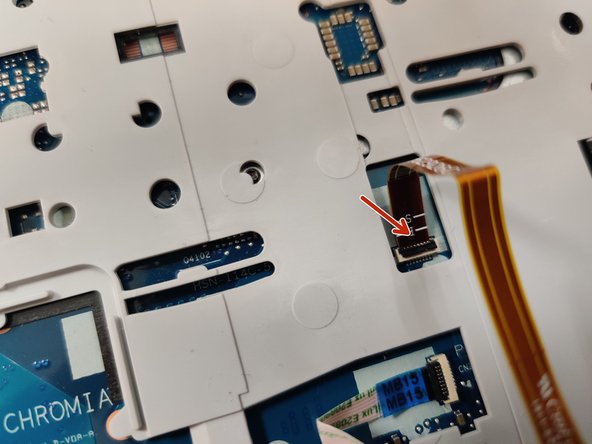

    4. HP ProBook 650 G4 Keyboard Replacement, Release Ribbon Cables: crwdns2935265:04crwdnd2935265:01crwdnd2935265:03crwdne2935265:0 HP ProBook 650 G4 Keyboard Replacement, Release Ribbon Cables: crwdns2935265:04crwdnd2935265:02crwdnd2935265:03crwdne2935265:0 HP ProBook 650 G4 Keyboard Replacement, Release Ribbon Cables: crwdns2935265:04crwdnd2935265:03crwdnd2935265:03crwdne2935265:0
      • with a plastic spudger tool flip up the black clips to release the ribbon cables
      • Gently pull out the cables, there should be no resistance if the clips were opened properly.
      • There may be some adhesive connecting the cable to the keyboard (green arrow).

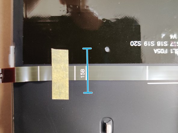

    5. HP ProBook 650 G4 Keyboard Replacement, Install New Ribbon Cables: crwdns2935265:05crwdnd2935265:01crwdnd2935265:02crwdne2935265:0 HP ProBook 650 G4 Keyboard Replacement, Install New Ribbon Cables: crwdns2935265:05crwdnd2935265:02crwdnd2935265:02crwdne2935265:0
      • Gently fold the new ribbon cables at the 15B line
      • Gently push in the ribbon cables and press down the black clips.
      • Make sure that the cables are pushed in far enough. They have a line marking how far they should be inserted.
      • Slide in the bottom clips of the keyboard and flip towards the screen
      • Push the keyboard all around until all of the clips click into place.
