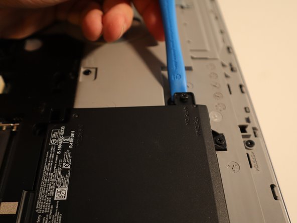

  3. HP ProBook 650 G2 Battery Replacement, Remove the battery: crwdns2935265:03crwdnd2935265:01crwdnd2935265:02crwdne2935265:0 HP ProBook 650 G2 Battery Replacement, Remove the battery: crwdns2935265:03crwdnd2935265:02crwdnd2935265:02crwdne2935265:0
    • There are 7 captive screws (on the original HP battery) around the edge of the battery that use a PH1 bit
    • Once the screws are removed you can use the tab nearest the front center of the laptop to lift the battery up and out
  4. HP ProBook 650 G2 Battery Replacement, (Optional) Remove captive screws: crwdns2935265:04crwdnd2935265:01crwdnd2935265:01crwdne2935265:0
    • If your new battery did not come with the captive screws you can unscrew them from the old battery by applying pressure under the screw while unscrewing them so you can transfer them to the new battery
