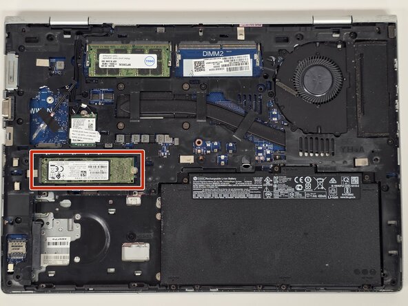

  3. HP ProBook 640 G5 SSD Replacement, SSD: crwdns2935265:03crwdnd2935265:01crwdnd2935265:03crwdne2935265:0 HP ProBook 640 G5 SSD Replacement, SSD: crwdns2935265:03crwdnd2935265:02crwdnd2935265:03crwdne2935265:0 HP ProBook 640 G5 SSD Replacement, SSD: crwdns2935265:03crwdnd2935265:03crwdnd2935265:03crwdne2935265:0
    • Avoid touching the gold contacts on the SSD. Handle components by the edges to prevent damage from static electricity or oils from your fingers.
    • Locate the SSD on the motherboard (typically a small rectangular module secured by a single screw).
    • Remove the single 3 mm screw securing the SSD using a Phillips #1 screwdriver.
    • Hold the SSD by the edges and gently remove it from the slot.
