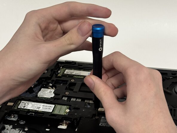

    • Flip the laptop over so the bottom is facing up.
    • Loosen eight silver 6mm screws using a Phillips #0 screwdriver.
    • These screws are captive, so they will loosen but remain attached to the cover.
    • Remove two black 6mm screws using a TR7 Torx screwdriver.
    • Insert a plastic opening tool into the seam and gently pry around the edges.
    • Lift the bottom cover away from the laptop.
  3. HP ProBook 640 G5 Battery Replacement, Battery: crwdns2935265:03crwdnd2935265:01crwdnd2935265:03crwdne2935265:0 HP ProBook 640 G5 Battery Replacement, Battery: crwdns2935265:03crwdnd2935265:02crwdnd2935265:03crwdne2935265:0 HP ProBook 640 G5 Battery Replacement, Battery: crwdns2935265:03crwdnd2935265:03crwdnd2935265:03crwdne2935265:0
    • Remove six 6mm and two 2mm screws using a Phillips #0 screwdriver.
    • The screws on the battery can be hard to remove as they need to be unscrewed, stood up, then unscrewed fully. You can use the tweezers to pull up the screw in place. You'll know it's in the proper place when you go to unscrew it and it comes out smoothly.
  4. HP ProBook 640 G5 Battery Replacement: crwdns2935265:04crwdnd2935265:01crwdnd2935265:02crwdne2935265:0 HP ProBook 640 G5 Battery Replacement: crwdns2935265:04crwdnd2935265:02crwdnd2935265:02crwdne2935265:0
    • Lift the battery near the lower end and pull it out of the slot on the top.
