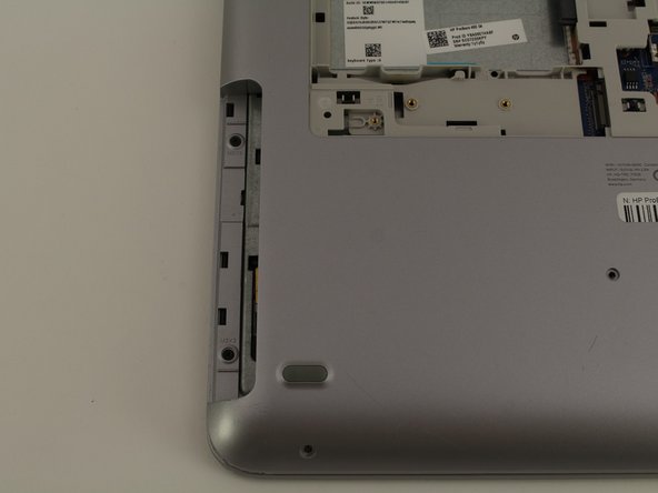

    • Power your laptop off.
    • Flip the laptop over.
    • Orient the laptop so the two vents on the bottom face upward and are further away from you.
  2. HP ProBook 450 G4 Disk Drive Replacement: crwdns2935265:02crwdnd2935265:01crwdnd2935265:03crwdne2935265:0 HP ProBook 450 G4 Disk Drive Replacement: crwdns2935265:02crwdnd2935265:02crwdnd2935265:03crwdne2935265:0 HP ProBook 450 G4 Disk Drive Replacement: crwdns2935265:02crwdnd2935265:03crwdnd2935265:03crwdne2935265:0
    • Use the Phillips #0 screwdriver to remove the 6.8 mm screw that secures the vent panel to the laptop.
    • Use the spudger to separate the vent panel from the laptop.
    • Slide the vent panel off the backside of the laptop.
  3. HP ProBook 450 G4 Disk Drive Replacement: crwdns2935265:03crwdnd2935265:01crwdnd2935265:02crwdne2935265:0 HP ProBook 450 G4 Disk Drive Replacement: crwdns2935265:03crwdnd2935265:02crwdnd2935265:02crwdne2935265:0
    • Use the Phillips #0 screwdriver to remove the black 3.2mm screw that secures the disk drive to the left side of the laptop.
  4. HP ProBook 450 G4 Disk Drive Replacement: crwdns2935265:04crwdnd2935265:01crwdnd2935265:02crwdne2935265:0 HP ProBook 450 G4 Disk Drive Replacement: crwdns2935265:04crwdnd2935265:02crwdnd2935265:02crwdne2935265:0
    • Use the spudger to push the disk drive out of the laptop.
