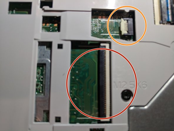

  10. HP ProBook 450 G3 Fan Replacement: crwdns2935265:010crwdnd2935265:01crwdnd2935265:01crwdne2935265:0
    • To remove the keyboard, gently insert the spudger underneath it along an edge and work it around to unsnap
  11. HP ProBook 450 G3 Fan Replacement: crwdns2935265:011crwdnd2935265:01crwdnd2935265:02crwdne2935265:0 HP ProBook 450 G3 Fan Replacement: crwdns2935265:011crwdnd2935265:02crwdnd2935265:02crwdne2935265:0
    • Once keyboard is removed, there will be two ribbon cables connecting the keyboard to the laptop. there will be two latches holding the cables in place on the laptop. to undo these latches, insert a spudger underneath the latch and lift up to free the cable.
  12. HP ProBook 450 G3 Fan Replacement: crwdns2935265:012crwdnd2935265:01crwdnd2935265:02crwdne2935265:0 HP ProBook 450 G3 Fan Replacement: crwdns2935265:012crwdnd2935265:02crwdnd2935265:02crwdne2935265:0
    • Do the same for the removal of the ribbon cable connecting the motherboard to the wireless card.

Multiple mistakes with the screws, the one’s underneath the Keyboard are T9’s, many screw positions are wrong or missing, changed were already made.
Juan Lara - crwdns2934203:0crwdne2934203:0
The 4 screws in the corners under the black rubber pads are missing in this guide!
Marc Brehm - crwdns2934203:0crwdne2934203:0
