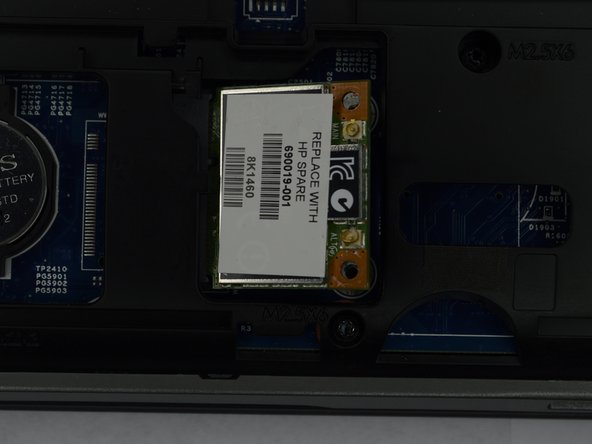

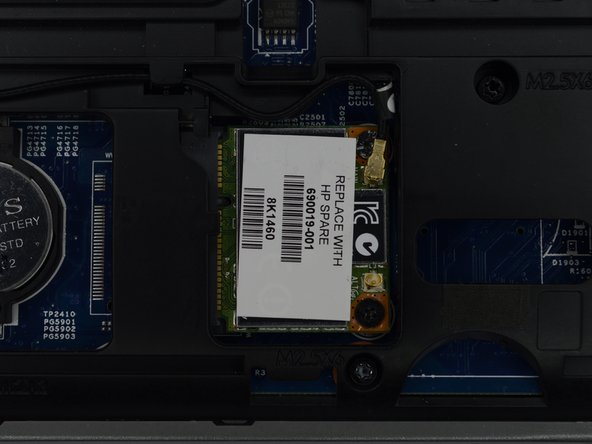

    • Locate the Wifi card, found opposite the battery and across from the hard drive.

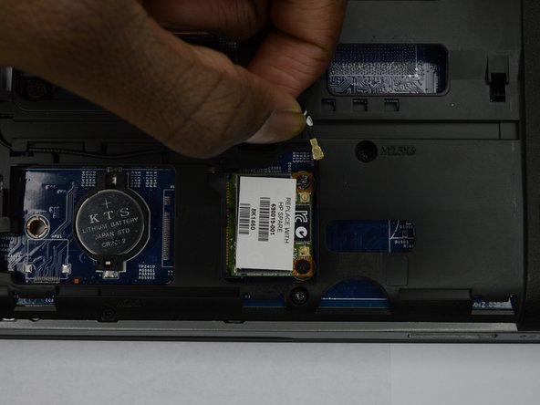

    • Remove the wire located near the screws on the wifi card.

    • Remove the two Phillips #00 screws holding the wifi card in place.
