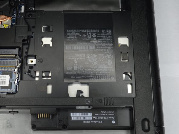

    • Make sure the laptop is turned off before you start.
    • Push and hold the release tab on the right and left toward the center.
  2. HP ProBook 440 G1 Optical Drive Replacement: crwdns2935265:02crwdnd2935265:01crwdnd2935265:02crwdne2935265:0 HP ProBook 440 G1 Optical Drive Replacement: crwdns2935265:02crwdnd2935265:02crwdnd2935265:02crwdne2935265:0
    • Pull the battery out.

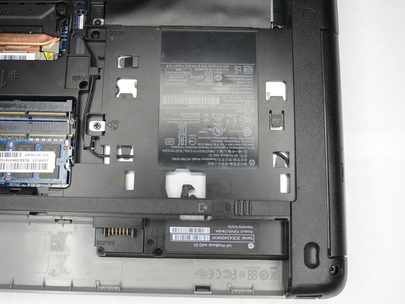

  3. HP ProBook 440 G1 Optical Drive Replacement, Backplate: crwdns2935265:03crwdnd2935265:01crwdnd2935265:03crwdne2935265:0 HP ProBook 440 G1 Optical Drive Replacement, Backplate: crwdns2935265:03crwdnd2935265:02crwdnd2935265:03crwdne2935265:0 HP ProBook 440 G1 Optical Drive Replacement, Backplate: crwdns2935265:03crwdnd2935265:03crwdnd2935265:03crwdne2935265:0
    • Push and hold the release tabs on the right and left toward the center again.
  4. HP ProBook 440 G1 Optical Drive Replacement: crwdns2935265:04crwdnd2935265:01crwdnd2935265:01crwdne2935265:0
    • Slide the backplate off.

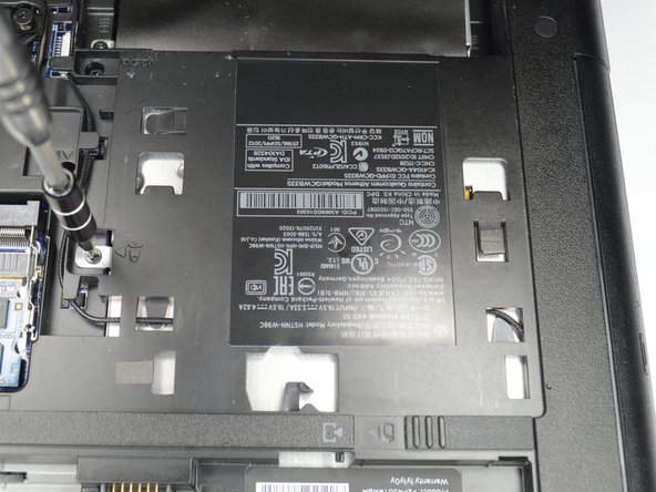

  5. HP ProBook 440 G1 Optical Drive Replacement, Optical Drive: crwdns2935265:05crwdnd2935265:01crwdnd2935265:02crwdne2935265:0 HP ProBook 440 G1 Optical Drive Replacement, Optical Drive: crwdns2935265:05crwdnd2935265:02crwdnd2935265:02crwdne2935265:0
    • Locate the optical drive, near the battery on the right side.
  6. HP ProBook 440 G1 Optical Drive Replacement: crwdns2935265:06crwdnd2935265:01crwdnd2935265:03crwdne2935265:0 HP ProBook 440 G1 Optical Drive Replacement: crwdns2935265:06crwdnd2935265:02crwdnd2935265:03crwdne2935265:0 HP ProBook 440 G1 Optical Drive Replacement: crwdns2935265:06crwdnd2935265:03crwdnd2935265:03crwdne2935265:0
    • Remove the Philips PM2.5x6.0 screw that attaches the optical drive to the computer.

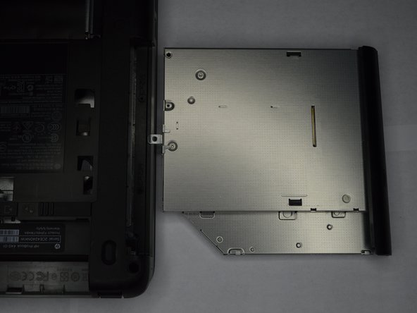

  7. HP ProBook 440 G1 Optical Drive Replacement: crwdns2935265:07crwdnd2935265:01crwdnd2935265:02crwdne2935265:0 HP ProBook 440 G1 Optical Drive Replacement: crwdns2935265:07crwdnd2935265:02crwdnd2935265:02crwdne2935265:0
    • Slowly remove the optical drive, by pulling it straight out of the slot.
