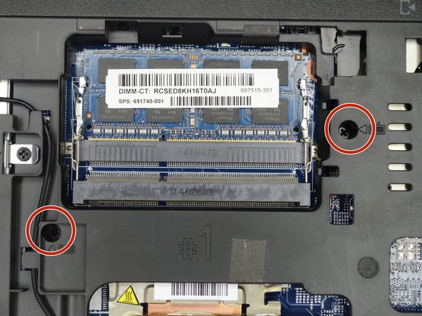

  5. HP ProBook 440 G1 Keyboard Replacement, Keyboard: crwdns2935265:05crwdnd2935265:01crwdnd2935265:02crwdne2935265:0 HP ProBook 440 G1 Keyboard Replacement, Keyboard: crwdns2935265:05crwdnd2935265:02crwdnd2935265:02crwdne2935265:0
    • Locate the two screws on the back of the laptop, holding the keyboard.
    • Remove the two screws using a Phillips #00 screwdriver.

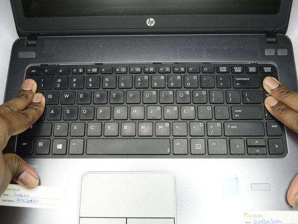

  7. HP ProBook 440 G1 Keyboard Replacement: crwdns2935265:07crwdnd2935265:01crwdnd2935265:02crwdne2935265:0 HP ProBook 440 G1 Keyboard Replacement: crwdns2935265:07crwdnd2935265:02crwdnd2935265:02crwdne2935265:0
    • Place both hands on the keyboard and slide it back.
    • The keyboard will only slide back a small amount.

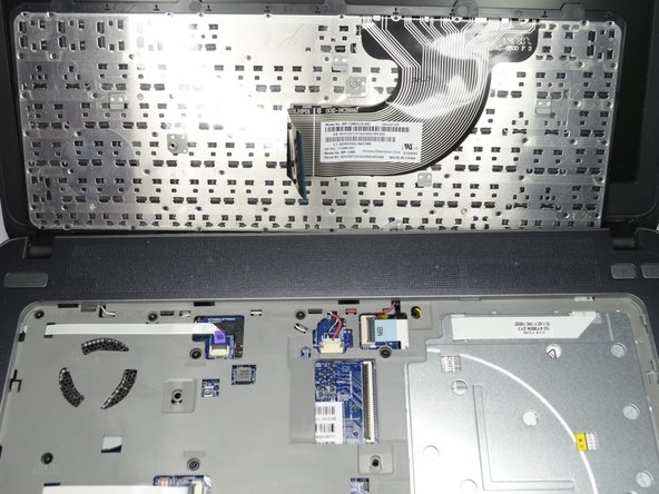

  8. HP ProBook 440 G1 Keyboard Replacement: crwdns2935265:08crwdnd2935265:01crwdnd2935265:02crwdne2935265:0 HP ProBook 440 G1 Keyboard Replacement: crwdns2935265:08crwdnd2935265:02crwdnd2935265:02crwdne2935265:0
    • Using a plastic opening tool, pull the keyboard up.

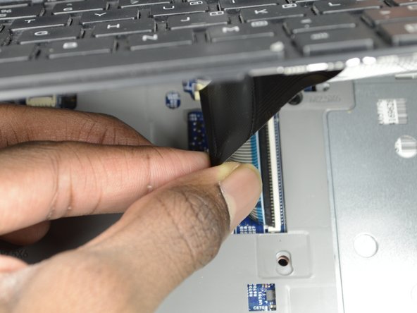

  9. HP ProBook 440 G1 Keyboard Replacement: crwdns2935265:09crwdnd2935265:01crwdnd2935265:03crwdne2935265:0 HP ProBook 440 G1 Keyboard Replacement: crwdns2935265:09crwdnd2935265:02crwdnd2935265:03crwdne2935265:0 HP ProBook 440 G1 Keyboard Replacement: crwdns2935265:09crwdnd2935265:03crwdnd2935265:03crwdne2935265:0
    • Locate the connector strip between the keyboard and the laptop.
    • Pull the strip away from the connector until it unplugs.
    • It may take some force to make the strip disconnect.
