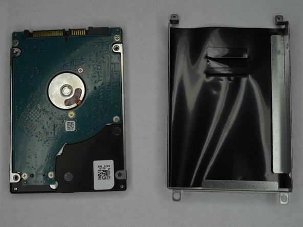

  8. HP ProBook 440 G1 Hard Disc Drive (HDD) Replacement: crwdns2935265:08crwdnd2935265:01crwdnd2935265:02crwdne2935265:0 HP ProBook 440 G1 Hard Disc Drive (HDD) Replacement: crwdns2935265:08crwdnd2935265:02crwdnd2935265:02crwdne2935265:0
    • Remove the four Phillips #00 screws holding the HDD in the HDD cover.
    • The HDD should slide out after all screws are removed.
