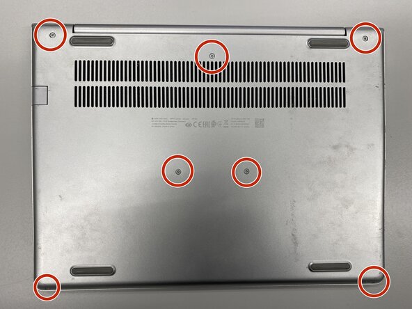

  1. HP ProBook 430 G6 Basic Disassembly, Remove the screws from the base: crwdns2935265:01crwdnd2935265:01crwdnd2935265:01crwdne2935265:0
    • Turn off the laptop and remove power cable.
    • Flip the laptop upside down.
    • Remove the labeled screws with Phillips #0 screwdriver.

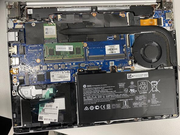

  2. HP ProBook 430 G6 Basic Disassembly, Remove the base: crwdns2935265:02crwdnd2935265:01crwdnd2935265:01crwdne2935265:0
    • Remove the metal base with iFixit Opening Tool or Opening Picks.
  3. HP ProBook 430 G6 Basic Disassembly, Disconnect the battery: crwdns2935265:03crwdnd2935265:01crwdnd2935265:01crwdne2935265:0
    • Disconnect the battery by removing the labeled screws and lifting the battery upwards from the box-labeled connector.
    • Battery disconnecting is very important to do before any replacements!
