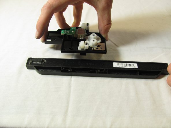

  12. HP Photosmart c3180 Scanner Bulb Replacement: crwdns2935265:012crwdnd2935265:01crwdnd2935265:02crwdne2935265:0 HP Photosmart c3180 Scanner Bulb Replacement: crwdns2935265:012crwdnd2935265:02crwdnd2935265:02crwdne2935265:0
    • Remove the scanner carriage from the scanner tray and flip it upside down.
    • Remove the two T10 12mm Torx screws.
    • Remove the scanner carriage from the scanner bulb.
