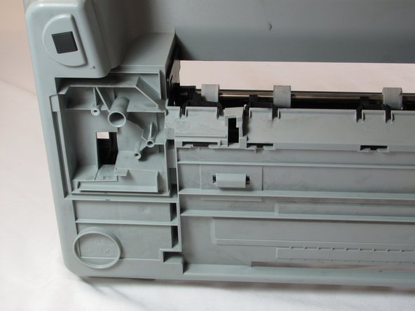

    • Rotate the printer 90 degrees counter clockwise so that the side panel next to control panel is facing you.
    • Remove the two T10 12mm Torx screws from the left side panel.
  2. HP Photosmart c3180 Main Circuit Board Replacement: crwdns2935265:02crwdnd2935265:01crwdnd2935265:02crwdne2935265:0 HP Photosmart c3180 Main Circuit Board Replacement: crwdns2935265:02crwdnd2935265:02crwdnd2935265:02crwdne2935265:0
    • Firmly pull the the back of the side panel until it separates from the body of the printer.
    • Rotate the side panel upwards while pulling it towards yourself to remove the panel.

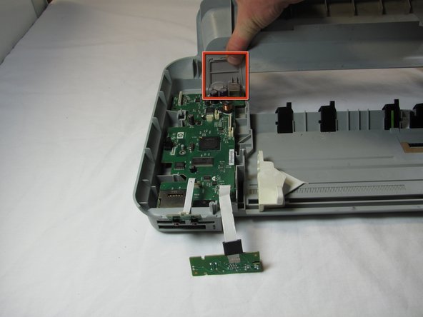

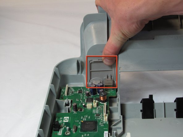

  7. HP Photosmart c3180 Main Circuit Board Replacement: crwdns2935265:07crwdnd2935265:01crwdnd2935265:02crwdne2935265:0 HP Photosmart c3180 Main Circuit Board Replacement: crwdns2935265:07crwdnd2935265:02crwdnd2935265:02crwdne2935265:0
    • Rotate the printer 90 degrees counter clockwise.
    • Inside the printer is a small white tab. Press it inward with a spudger until a pop is heard.
    • Remove the front panel by grasping its front and pulling away from the printer.

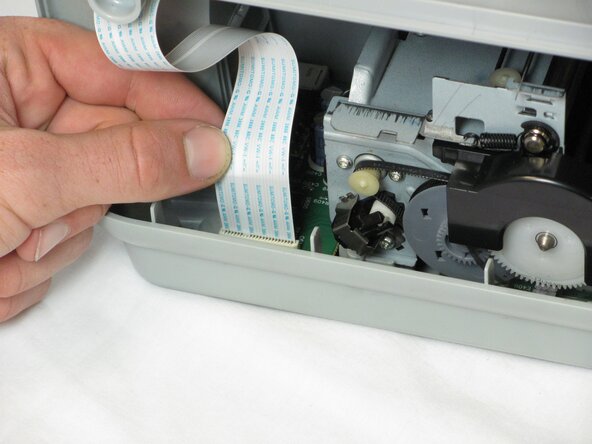

  11. HP Photosmart c3180 Main Circuit Board Replacement: crwdns2935265:011crwdnd2935265:01crwdnd2935265:02crwdne2935265:0 HP Photosmart c3180 Main Circuit Board Replacement: crwdns2935265:011crwdnd2935265:02crwdnd2935265:02crwdne2935265:0
    • Rotate the Printer 90 degrees counter clockwise.
    • Remove the scanner cable from the main circuit board.
    • Grasp the bottom of the cable and pull straight up. Do not wiggle it from side to side or twist it as this can damage the connection.

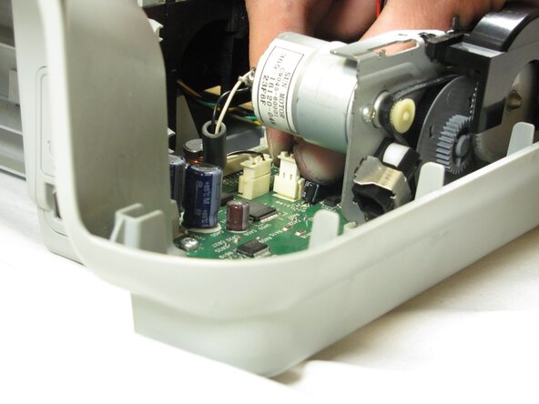

  21. HP Photosmart c3180 Main Circuit Board Replacement: crwdns2935265:021crwdnd2935265:01crwdnd2935265:01crwdne2935265:0
    • Carefully remove the connector holding the drive motor wires to the main circuit board.

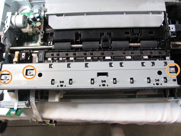

    • Remove the three T10 12mm Torx screws holding the paper guide to the printer body.
    • Lift the paper guide directly up to remove it and set it aside.

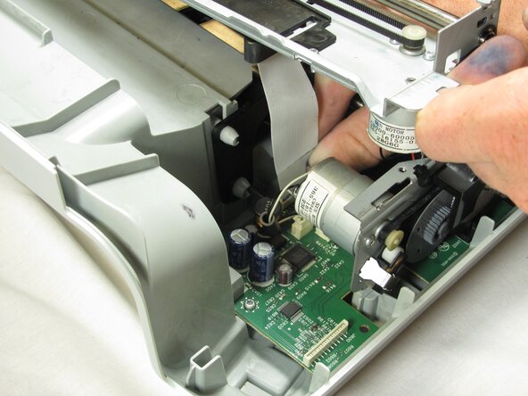

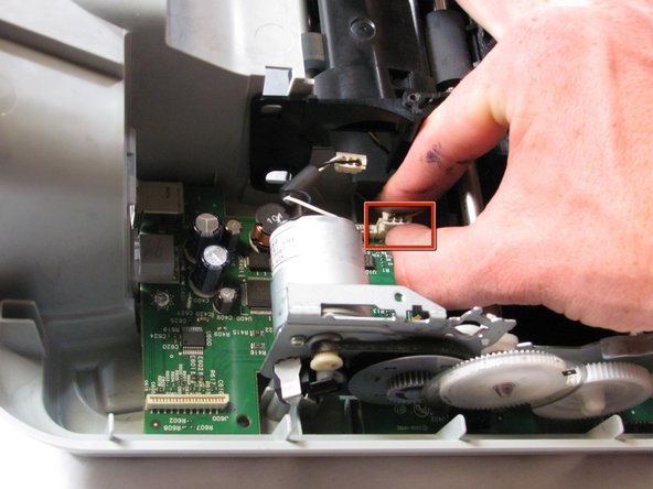

    • Remove the connector holding the feed roller motor to the logic board by pulling it strait up
    • Remove the T10 12mm Torx screw on the roller panel.
  29. HP Photosmart c3180 Main Circuit Board Replacement: crwdns2935265:029crwdnd2935265:01crwdnd2935265:02crwdne2935265:0 HP Photosmart c3180 Main Circuit Board Replacement: crwdns2935265:029crwdnd2935265:02crwdnd2935265:02crwdne2935265:0
    • Disconnect the page sensor from the logic board by pulling straight up on the connector.

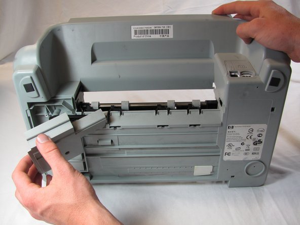

    • Rotate the printer 180 degrees and turn it up on to the front side, so that the back of the printer is facing up and the bottom facing you.
    • Be careful because the feed roller assembly is now loose, but it is still attached to the main body of the printer.
    • Push in the tab on the left side of the back panel and pull outward to remove the back panel.
