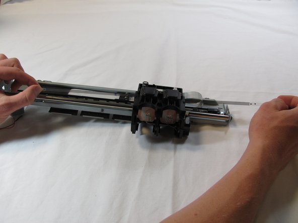

  23. HP Photosmart c3180 Encoder Strip Replacement, Encoder Strip: crwdns2935265:023crwdnd2935265:01crwdnd2935265:03crwdne2935265:0 HP Photosmart c3180 Encoder Strip Replacement, Encoder Strip: crwdns2935265:023crwdnd2935265:02crwdnd2935265:03crwdne2935265:0 HP Photosmart c3180 Encoder Strip Replacement, Encoder Strip: crwdns2935265:023crwdnd2935265:03crwdnd2935265:03crwdne2935265:0
    • Set aside the printer body
    • Unhook the encoding strip by pinching it on the right side and pulling away from the center of the ink cartridge track.

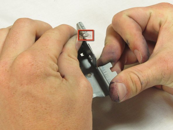

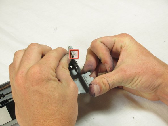

  24. HP Photosmart c3180 Encoder Strip Replacement: crwdns2935265:024crwdnd2935265:01crwdnd2935265:02crwdne2935265:0 HP Photosmart c3180 Encoder Strip Replacement: crwdns2935265:024crwdnd2935265:02crwdnd2935265:02crwdne2935265:0
    • Rotate the Track 180 degrees and slide the printer carriage slightly to the left.
    • Grasp the metal tab holding the encoding strip and pull it away from the track while pulling it up.
    • Without releasing the metal tab, pull the encoding strip through the ink cartridge carriage. The encoding strip should slide out smoothly.
