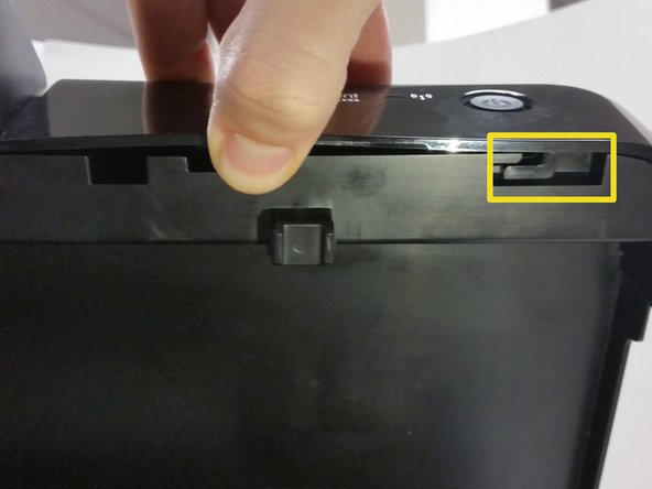

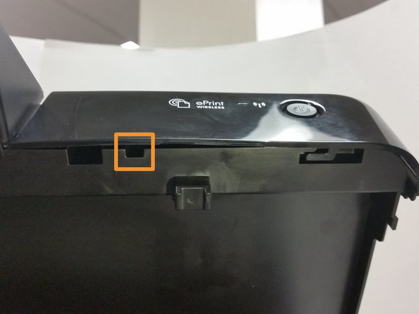

  9. HP Photosmart Premium e-All-in-One C310a Power Button Replacement, Remove the Cover Plate: crwdns2935265:09crwdnd2935265:01crwdnd2935265:03crwdne2935265:0 HP Photosmart Premium e-All-in-One C310a Power Button Replacement, Remove the Cover Plate: crwdns2935265:09crwdnd2935265:02crwdnd2935265:03crwdne2935265:0 HP Photosmart Premium e-All-in-One C310a Power Button Replacement, Remove the Cover Plate: crwdns2935265:09crwdnd2935265:03crwdnd2935265:03crwdne2935265:0
    • Pull the side of the cover plate away from the printer until it is off of the locking peg.
    • Pull the middle of the cover plate away from the printer until the tab in the middle is free.
    • Slide the cover plate to the right to disengage the latch.
