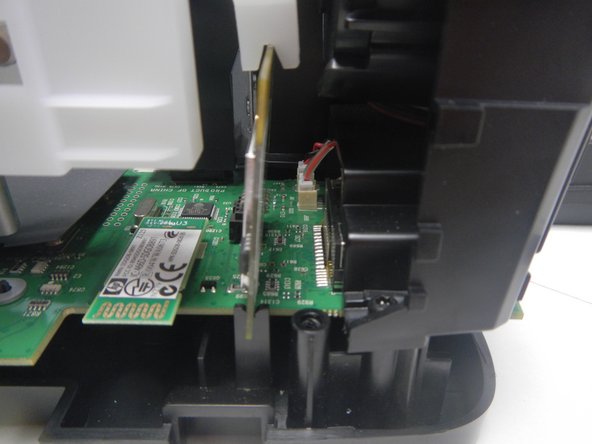

  3. HP Photosmart Premium C309g Wireless Card Replacement: crwdns2935265:03crwdnd2935265:01crwdnd2935265:01crwdne2935265:0
    • After unscrewing the screw, the left side will slide down revealing the wireless card.

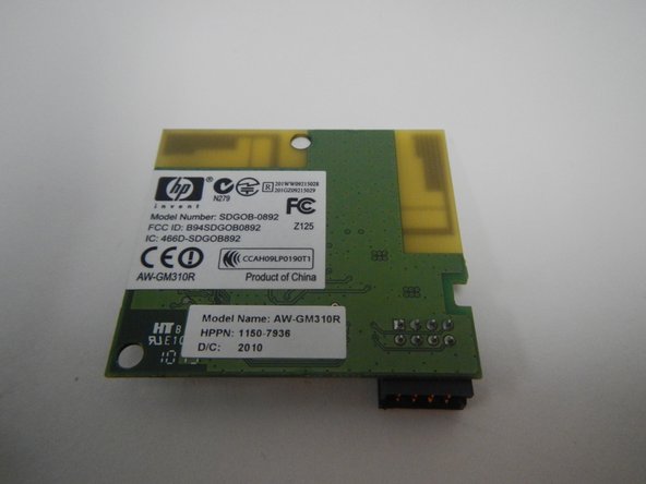

  4. HP Photosmart Premium C309g Wireless Card Replacement: crwdns2935265:04crwdnd2935265:01crwdnd2935265:03crwdne2935265:0 HP Photosmart Premium C309g Wireless Card Replacement: crwdns2935265:04crwdnd2935265:02crwdnd2935265:03crwdne2935265:0 HP Photosmart Premium C309g Wireless Card Replacement: crwdns2935265:04crwdnd2935265:03crwdnd2935265:03crwdne2935265:0
    • Unscrew one 12mm screw and gently disconnect the wireless card from the motherboard.
