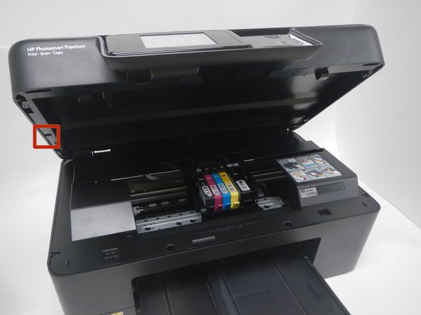

    • Open the top of printer. The printer should appear as shown.

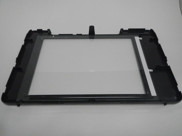

    • Lift the scanner glass piece from the printer and set it aside.

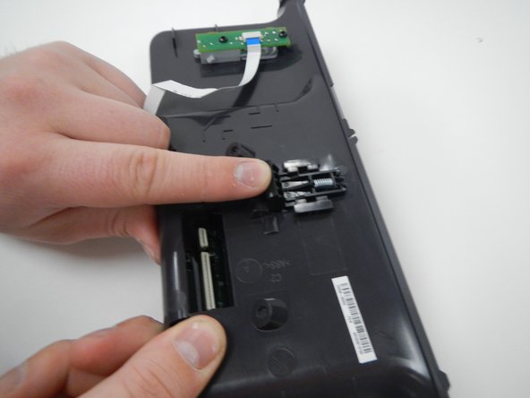

    • Place thumb and forefinger where shown and pull this piece away from the printer.
    • Do not pull it away too hard. The piece is still connected by wiring ribbon.
