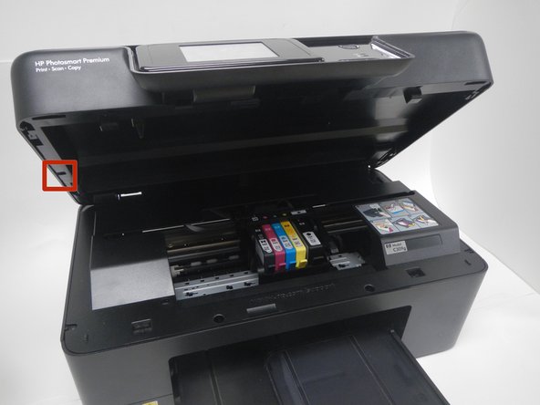

    • Open the top of the printer. The printer should appear as shown.
  2. HP Photosmart Premium C309g Scanner Glass  Replacement: crwdns2935265:02crwdnd2935265:01crwdnd2935265:02crwdne2935265:0 HP Photosmart Premium C309g Scanner Glass  Replacement: crwdns2935265:02crwdnd2935265:02crwdnd2935265:02crwdne2935265:0
    • Use the blue plastic opening tool to pry the trim pieces all the way around the printer.
    • Loosen the pieces around the edges before pulling to remove from the printer.
    • Pull the (4) trim pieces off and set them aside.
  3. HP Photosmart Premium C309g Scanner Glass  Replacement: crwdns2935265:03crwdnd2935265:01crwdnd2935265:02crwdne2935265:0 HP Photosmart Premium C309g Scanner Glass  Replacement: crwdns2935265:03crwdnd2935265:02crwdnd2935265:02crwdne2935265:0
    • Using the blue plastic opening tool, pull from the middle and then slide back to remove the side panels.
    • The side trim pieces need to be removed before the front trim pieces.

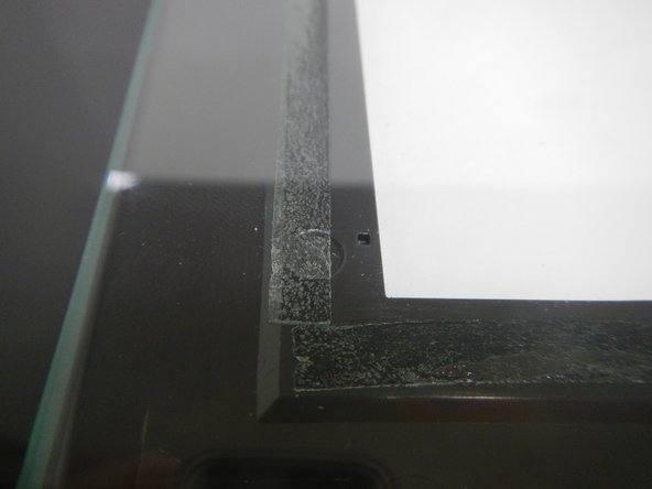

  6. HP Photosmart Premium C309g Scanner Glass  Replacement: crwdns2935265:06crwdnd2935265:01crwdnd2935265:01crwdne2935265:0
    • Lift the scanner glass piece from the printer.
  7. HP Photosmart Premium C309g Scanner Glass  Replacement: crwdns2935265:07crwdnd2935265:01crwdnd2935265:02crwdne2935265:0 HP Photosmart Premium C309g Scanner Glass  Replacement: crwdns2935265:07crwdnd2935265:02crwdnd2935265:02crwdne2935265:0
    • The scanner glass is attached to the plastic piece with adhesive tape.
    • Pull off the glass and re-set new piece of glass.

Hi there,
I see these instructions was published some time ago and I hope someone still knows something about this printer. I have a question about step 2 and 3. It says you are to pry trim pieces and remove side panels. What is the difference between these two? When I lift the scanner module (or whatever it's called) I see only one type of panels. And wouldn't step 2 be easier if the scanner module is lifted first as in step 3? I don't understand why it's done as shown, but maybe there is a certain reason.
The front and the side panels have hooks that are attached to the underside of the module, so there seem to be no way to pull the panels outwards. Looks more like they should be pulled downwards, but seeing how the plastic frame around the scanner glass looks in the picture at step 6 I assume that's not possible. Could someone please explain step 2 and 3 for me?
