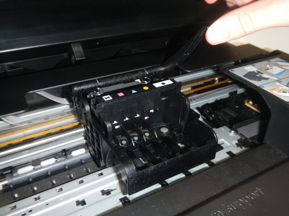

    • Open the top of the printer as shown.
    • Locate the ink cartridges housed by the printhead.
  2. HP Photosmart Premium C309g Printhead Replacement: crwdns2935265:02crwdnd2935265:01crwdnd2935265:02crwdne2935265:0 HP Photosmart Premium C309g Printhead Replacement: crwdns2935265:02crwdnd2935265:02crwdnd2935265:02crwdne2935265:0
    • Remove each ink cartridge by pushing the tab and lifting the cartridge.
    • Set all 5 cartridges aside.
  3. HP Photosmart Premium C309g Printhead Replacement: crwdns2935265:03crwdnd2935265:01crwdnd2935265:03crwdne2935265:0 HP Photosmart Premium C309g Printhead Replacement: crwdns2935265:03crwdnd2935265:02crwdnd2935265:03crwdne2935265:0 HP Photosmart Premium C309g Printhead Replacement: crwdns2935265:03crwdnd2935265:03crwdnd2935265:03crwdne2935265:0

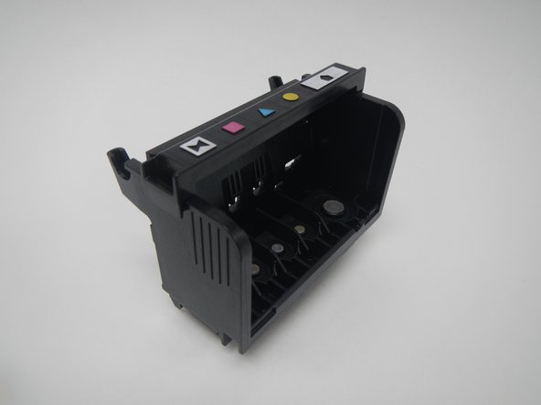

    • Lift the lever located on the right side of the printhead.
  4. HP Photosmart Premium C309g Printhead Replacement: crwdns2935265:04crwdnd2935265:01crwdnd2935265:02crwdne2935265:0 HP Photosmart Premium C309g Printhead Replacement: crwdns2935265:04crwdnd2935265:02crwdnd2935265:02crwdne2935265:0
    • Lift the printhead and remove it.
