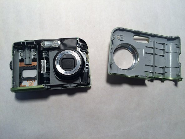

  4. HP Photosmart M547 Screen Replacement: crwdns2935265:04crwdnd2935265:01crwdnd2935265:02crwdne2935265:0 HP Photosmart M547 Screen Replacement: crwdns2935265:04crwdnd2935265:02crwdnd2935265:02crwdne2935265:0
    • Make sure that the siding is fully removed and the battery dock is open. Carefully pry the top off of the camera.

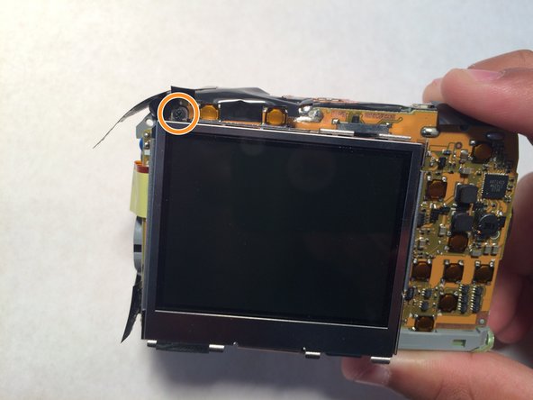

  7. HP Photosmart M547 Screen Replacement: crwdns2935265:07crwdnd2935265:01crwdnd2935265:02crwdne2935265:0 HP Photosmart M547 Screen Replacement: crwdns2935265:07crwdnd2935265:02crwdnd2935265:02crwdne2935265:0
    • Look for the silver 5mm screw connecting the screen to the circuit board. Then carefully remove it using a PH00 screwdriver.
    • On the opposite corner of the screen there is a similar screw. Carefully remove that one as well.
    • You may need to peel back thin, black plastic to get to the screw. The plastic is purely there for dust protection.
