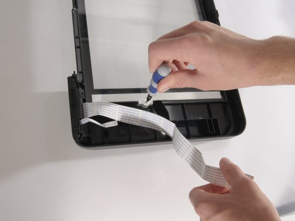

  11. HP Photosmart D110a Scanner Glass Replacement, Scanner Glass: crwdns2935265:011crwdnd2935265:01crwdnd2935265:02crwdne2935265:0 HP Photosmart D110a Scanner Glass Replacement, Scanner Glass: crwdns2935265:011crwdnd2935265:02crwdnd2935265:02crwdne2935265:0
    • The scanner glass is held down by one T-9 screw. Use a screw driver to remove the screw.

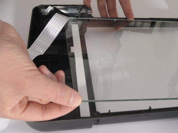

  12. HP Photosmart D110a Scanner Glass Replacement: crwdns2935265:012crwdnd2935265:01crwdnd2935265:02crwdne2935265:0 HP Photosmart D110a Scanner Glass Replacement: crwdns2935265:012crwdnd2935265:02crwdnd2935265:02crwdne2935265:0
    • Once the screw has been taken out, lift the glass covering from the bottom left corner as shown.
    • The other corner of the glass can now be lifted up as well. Use the two corners to lift up the whole scanner glass.

Very helpful guide, the scanner glass was dirty from inside, so the guide was able to give me clear instructions how to proceed with the openning. Thanks!
Alexandre Silva - crwdns2934203:0crwdne2934203:0 crwdns2950251:0crwdne2950251:0
Very helpful in most ways. I needed to clean the inside of the glass because the ribbon cable was leaving a discoloration when traveling and showed up on my scanned documents. I actually did this solo and was fine until reassemble faze when the actual scanner bar would not stay in place to reassemble the two parts. I finally got it back together after much profanity and no small amount of patients. The next dilemma was the reassembly of top to bottom which was easily fixed with a small piece of duct tape holding The right side in place while reconnecting the two ribbon cables and the power connector. All is back together and working fine. My thanx to my God and to you for a successful fix.

I found that it was actually a T10 bit on mine as well and found when removing the 3 screws shown in red a 2” bit works best but with the one marked in orange under the power button a 1” if placed in the screw first then pulled forward slightly I was able to use a 1/4” drive screwdriver on a slight angle which made it much faster to remove that one screw. That being said, still a very helpful fix to a problem that was really frustrating me as I kept cleaning the top of the glass until I realized the problem was on the underside.
