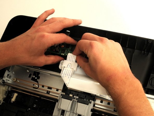

  7. HP Photosmart D110a Motherboard Replacement: crwdns2935265:07crwdnd2935265:01crwdnd2935265:03crwdne2935265:0 HP Photosmart D110a Motherboard Replacement: crwdns2935265:07crwdnd2935265:02crwdnd2935265:03crwdne2935265:0 HP Photosmart D110a Motherboard Replacement: crwdns2935265:07crwdnd2935265:03crwdnd2935265:03crwdne2935265:0
    • With a partner's help:
    • Have one person lift the hood 2-3 inches.
    • Have the other person disconnect the three cables from the motherboard (the green PCB) to the hood by gently pulling upward on them.
    • Remove the hood completely.

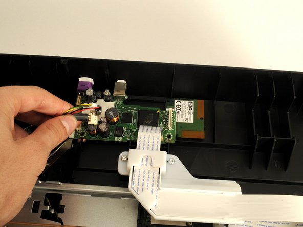

  8. HP Photosmart D110a Motherboard Replacement, Motherboard: crwdns2935265:08crwdnd2935265:01crwdnd2935265:02crwdne2935265:0 HP Photosmart D110a Motherboard Replacement, Motherboard: crwdns2935265:08crwdnd2935265:02crwdnd2935265:02crwdne2935265:0
    • Once the lid is removed, the motherboard (the only green PCB board) will become accessible.
  9. HP Photosmart D110a Motherboard Replacement: crwdns2935265:09crwdnd2935265:01crwdnd2935265:03crwdne2935265:0 HP Photosmart D110a Motherboard Replacement: crwdns2935265:09crwdnd2935265:02crwdnd2935265:03crwdne2935265:0 HP Photosmart D110a Motherboard Replacement: crwdns2935265:09crwdnd2935265:03crwdnd2935265:03crwdne2935265:0
    • Use a T9 Torx Security screwdriver to remove the three screws securing the motherboard.
    • With your fingers or a spudger, remove the cables and ribbon cable by gently pulling them free from their sockets.
  10. HP Photosmart D110a Motherboard Replacement: crwdns2935265:010crwdnd2935265:01crwdnd2935265:01crwdne2935265:0
    • Gently lift the mother board up from the printer and set it aside.
