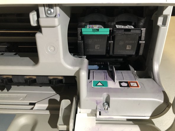

    • Pull the handle at the front of the printer to access the ink cartridges compartment.
    • The cartridges will be on the right side of the printer.
  3. HP Photosmart C4435 Ink Cartridge Replacement: crwdns2935265:03crwdnd2935265:01crwdnd2935265:03crwdne2935265:0 HP Photosmart C4435 Ink Cartridge Replacement: crwdns2935265:03crwdnd2935265:02crwdnd2935265:03crwdne2935265:0 HP Photosmart C4435 Ink Cartridge Replacement: crwdns2935265:03crwdnd2935265:03crwdnd2935265:03crwdne2935265:0
    • Press down on the top of the ink cartridge with little force to release them.
    • The teal cartridge is for colored ink. The black cartridge is for black ink.

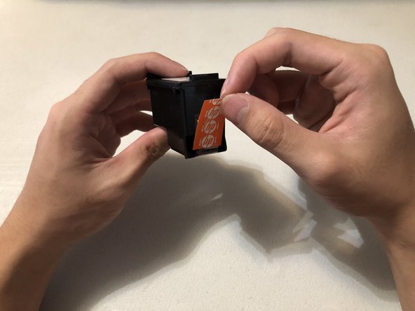

    • Remove the protective sticker on your new ink cartridge before using it.
