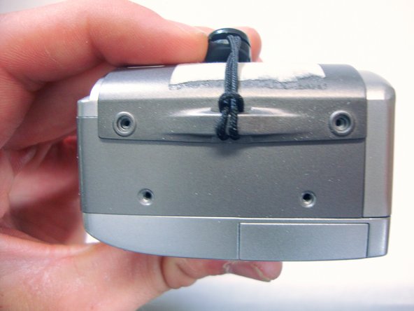

    • Flip the camera over so the bottom of the camera is facing you.
    • Turn the mode dial to the OFF position.
  2. HP Photosmart 935 Viewfinder Digital Camera Mirror and Lens Replacement: crwdns2935265:03crwdnd2935265:01crwdnd2935265:02crwdne2935265:0 HP Photosmart 935 Viewfinder Digital Camera Mirror and Lens Replacement: crwdns2935265:03crwdnd2935265:02crwdnd2935265:02crwdne2935265:0
    • Slide the bottom cover in the direction of the arrow to open it.
  3. HP Photosmart 935 Viewfinder Digital Camera Mirror and Lens Replacement: crwdns2935265:04crwdnd2935265:01crwdnd2935265:01crwdne2935265:0
    • Pull out the batteries.
  4. HP Photosmart 935 Viewfinder Digital Camera Mirror and Lens Replacement, Plastic Casing: crwdns2935265:05crwdnd2935265:01crwdnd2935265:01crwdne2935265:0
    • Use a Phillips #00 screwdriver to remove the two 4.7 mm screws in the bottom of the plastic casing.

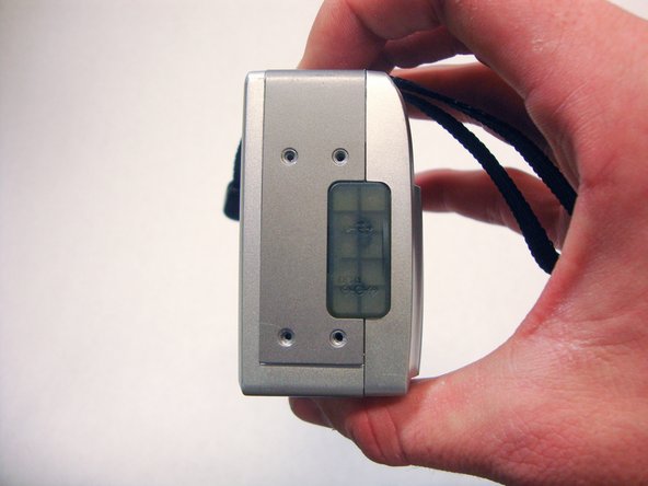

    • Remove the four 4.7 mm screws on the left side of the camera.
  6. HP Photosmart 935 Viewfinder Digital Camera Mirror and Lens Replacement: crwdns2935265:07crwdnd2935265:01crwdnd2935265:02crwdne2935265:0 HP Photosmart 935 Viewfinder Digital Camera Mirror and Lens Replacement: crwdns2935265:07crwdnd2935265:02crwdnd2935265:02crwdne2935265:0
    • Remove the four 4.7 mm screws on the opposite side of the camera.

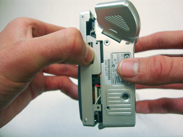

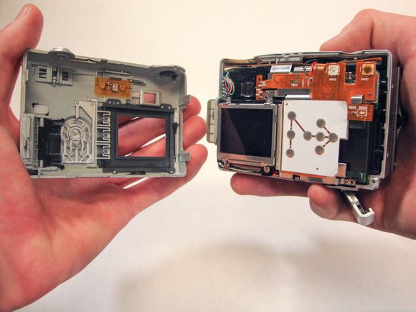

    • Use your thumbs to pry the case apart.
    • It is easiest to pry the case apart if you start at the bottom.
    • The case should come apart with minimal effort. If it doesn't, you can use a spudger or plastic opening tool to pry it open.

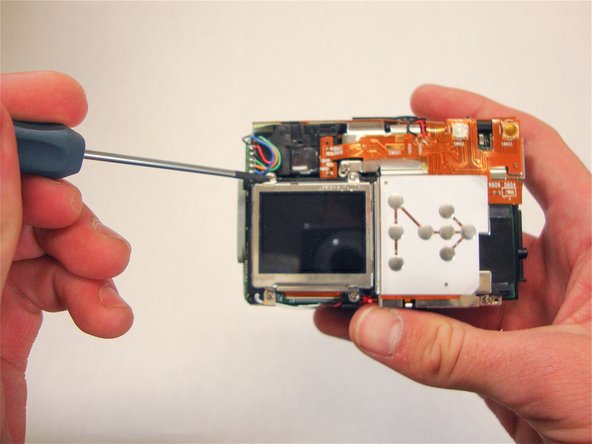

  11. HP Photosmart 935 Viewfinder Digital Camera Mirror and Lens Replacement: crwdns2935265:012crwdnd2935265:01crwdnd2935265:02crwdne2935265:0 HP Photosmart 935 Viewfinder Digital Camera Mirror and Lens Replacement: crwdns2935265:012crwdnd2935265:02crwdnd2935265:02crwdne2935265:0
    • Using a Phillips #00 remove the four 4.40 mm screws that secure the LCD screen to the frame.

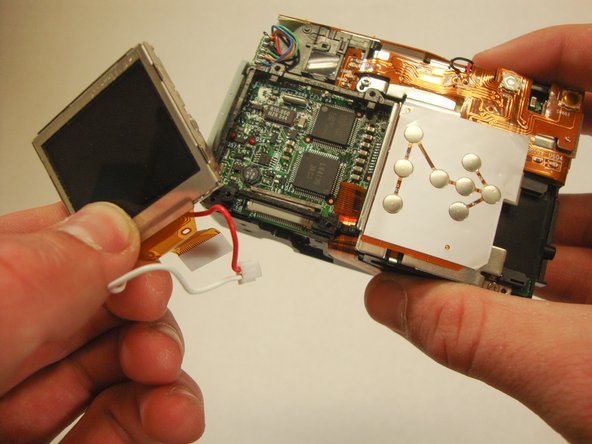

  12. HP Photosmart 935 Viewfinder Digital Camera Mirror and Lens Replacement: crwdns2935265:013crwdnd2935265:01crwdnd2935265:01crwdne2935265:0
    • Allow the LCD screen to flip down. This will expose the electric strip that connects the screen to the camera.
  13. HP Photosmart 935 Viewfinder Digital Camera Mirror and Lens Replacement: crwdns2935265:014crwdnd2935265:01crwdnd2935265:01crwdne2935265:0
    • Look for where the yellow electric strip is attached to the camera. You will find a plastic grey bar and a white base holding this strip in place.
    • Push the grey bar away from the white base. This will release the yellow electric strip and free the LCD screen from the camera.
  14. HP Photosmart 935 Viewfinder Digital Camera Mirror and Lens Replacement: crwdns2935265:015crwdnd2935265:01crwdnd2935265:01crwdne2935265:0
    • Unplug the connected red and white wires. They will come out with the small white casing.

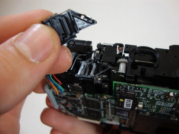

    • Orient the camera so that you are looking at the back of the camera. Directly above where the LCD screen was located, find the viewfinder cover clip.
    • Detach the clip with a pair of tweezers.
    • Push upwards and remove the viewfinder cover.
  23. HP Photosmart 935 Viewfinder Digital Camera Mirror and Lens Replacement: crwdns2935265:024crwdnd2935265:01crwdnd2935265:01crwdne2935265:0
    • Remove the viewfinder mirror by pulling up n the mirror with tweezers.
