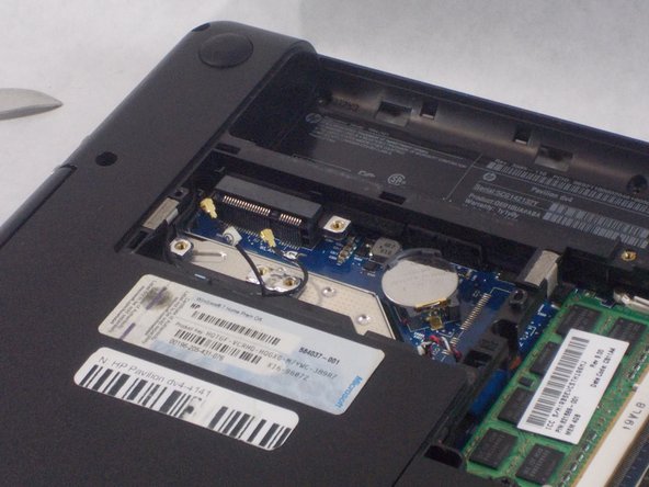

    • Lift up the back panel using a tool or your fingernail and remove it from the computer.
  2. HP Pavillion dv4-4141us Wi-Fi Card Replacement: crwdns2935265:02crwdnd2935265:01crwdnd2935265:01crwdne2935265:0
    • Using the Phillips #0 screwdriver, remove the two screws holding the Wi-Fi card in place.
  3. HP Pavillion dv4-4141us Wi-Fi Card Replacement: crwdns2935265:03crwdnd2935265:01crwdnd2935265:02crwdne2935265:0 HP Pavillion dv4-4141us Wi-Fi Card Replacement: crwdns2935265:03crwdnd2935265:02crwdnd2935265:02crwdne2935265:0
    • Lift up the Wi-Fi card from the side where the screws were removed and slide it out.
