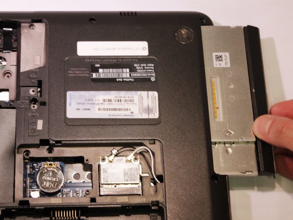

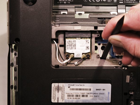

  6. HP Pavillion dm4t-2100 Touchpad Replacement, Touchpad: crwdns2935265:06crwdnd2935265:01crwdnd2935265:03crwdne2935265:0 HP Pavillion dm4t-2100 Touchpad Replacement, Touchpad: crwdns2935265:06crwdnd2935265:02crwdnd2935265:03crwdne2935265:0 HP Pavillion dm4t-2100 Touchpad Replacement, Touchpad: crwdns2935265:06crwdnd2935265:03crwdnd2935265:03crwdne2935265:0
    • Remove one Phillips M2.5X5.0 Screw that is securing the optical drive.
    • With the nylon spudger, push the optical drive until you can grab it.
    • Pull the optical drive all the way out, until removed.

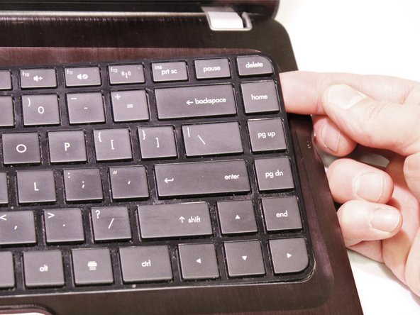

  7. HP Pavillion dm4t-2100 Touchpad Replacement: crwdns2935265:07crwdnd2935265:01crwdnd2935265:03crwdne2935265:0 HP Pavillion dm4t-2100 Touchpad Replacement: crwdns2935265:07crwdnd2935265:02crwdnd2935265:03crwdne2935265:0 HP Pavillion dm4t-2100 Touchpad Replacement: crwdns2935265:07crwdnd2935265:03crwdnd2935265:03crwdne2935265:0
    • Remove 2 Phillips M2.5X6.5 screws from the back of the computer.
    • Keyboard icons next to keyboard bolts
    • Turn the computer over, and open the computer as far as possible without breaking it.

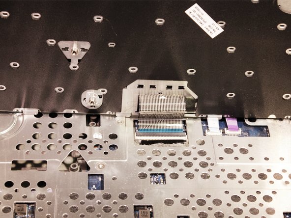

    • Release the top of the keyboard by lifting up and gently pull the top up until the whole keyboard is up.
    • Lift plastic cover to release the ZIF connector that is holding the keyboard in place. Then remove the keyboard.

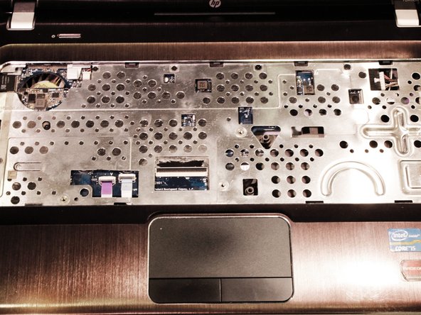

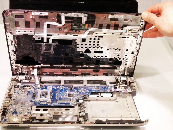

  9. HP Pavillion dm4t-2100 Touchpad Replacement: crwdns2935265:09crwdnd2935265:01crwdnd2935265:03crwdne2935265:0 HP Pavillion dm4t-2100 Touchpad Replacement: crwdns2935265:09crwdnd2935265:02crwdnd2935265:03crwdne2935265:0 HP Pavillion dm4t-2100 Touchpad Replacement: crwdns2935265:09crwdnd2935265:03crwdnd2935265:03crwdne2935265:0
    • Release 2 ZIF connectors where the touch pad cable and fingerprint reader are connected.
    • Remove 4 Phillips M2.0X4.0 screws near the top of the keyboard area.
    • Lift top cover from the base and release the ZIF connector that the power button is connected to. The cover should now be removed.
    • Using a nylon spudger could be helpful
    • Take the top cover and put it upside down and remove one Phillips M2.0X3.0 screw.
