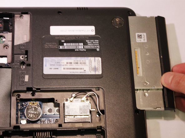

  6. HP Pavillion dm4t-2100 Screen Replacement, Screen: crwdns2935265:06crwdnd2935265:01crwdnd2935265:02crwdne2935265:0 HP Pavillion dm4t-2100 Screen Replacement, Screen: crwdns2935265:06crwdnd2935265:02crwdnd2935265:02crwdne2935265:0
    • Remove one Phillips M2.5X5.0 Screw that is securing the optical drive.
    • With the nylon spudger, push the optical drive until you can grab it and pull it all the way out.

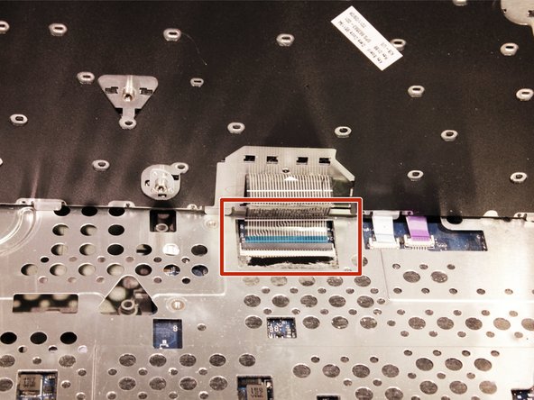

  8. HP Pavillion dm4t-2100 Screen Replacement: crwdns2935265:08crwdnd2935265:01crwdnd2935265:02crwdne2935265:0 HP Pavillion dm4t-2100 Screen Replacement: crwdns2935265:08crwdnd2935265:02crwdnd2935265:02crwdne2935265:0
    • Turn computer over and open the computer as far as possible without breaking it.
    • Release the top of the keyboard by lifting up, and gently pull the top up until the whole keyboard is up.
    • Release the ZIF connector that is holding the keyboard in place and remove the key board.

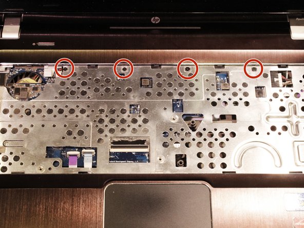

  10. HP Pavillion dm4t-2100 Screen Replacement: crwdns2935265:010crwdnd2935265:01crwdnd2935265:02crwdne2935265:0 HP Pavillion dm4t-2100 Screen Replacement: crwdns2935265:010crwdnd2935265:02crwdnd2935265:02crwdne2935265:0
    • Release 2 ZIF connectors where the touch pad cable and fingerprint reader are connected.
    • Remove 4 Phillips M2.0X4.0 screws near the top of the keyboard area.

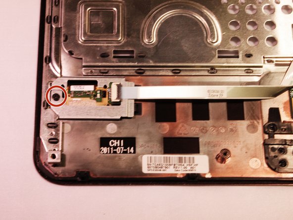

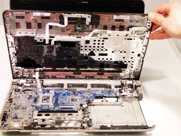

  11. HP Pavillion dm4t-2100 Screen Replacement: crwdns2935265:011crwdnd2935265:01crwdnd2935265:03crwdne2935265:0 HP Pavillion dm4t-2100 Screen Replacement: crwdns2935265:011crwdnd2935265:02crwdnd2935265:03crwdne2935265:0 HP Pavillion dm4t-2100 Screen Replacement: crwdns2935265:011crwdnd2935265:03crwdnd2935265:03crwdne2935265:0
    • Lift top cover from the base and release the ZIF connector that the power button is connected to.
    • Take the top cover and put it upside down and remove one 3mm Phillips #1 screw.

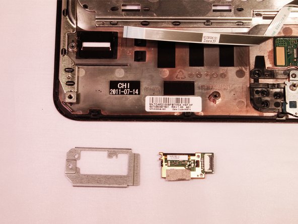

  12. HP Pavillion dm4t-2100 Screen Replacement: crwdns2935265:012crwdnd2935265:01crwdnd2935265:02crwdne2935265:0 HP Pavillion dm4t-2100 Screen Replacement: crwdns2935265:012crwdnd2935265:02crwdnd2935265:02crwdne2935265:0
    • Release ZIF connector on fingerprint reader and remove fingerprint reader board.

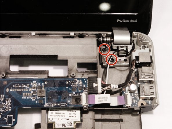

  13. HP Pavillion dm4t-2100 Screen Replacement: crwdns2935265:013crwdnd2935265:01crwdnd2935265:03crwdne2935265:0 HP Pavillion dm4t-2100 Screen Replacement: crwdns2935265:013crwdnd2935265:02crwdnd2935265:03crwdne2935265:0 HP Pavillion dm4t-2100 Screen Replacement: crwdns2935265:013crwdnd2935265:03crwdnd2935265:03crwdne2935265:0

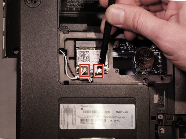

    • Disconnect the display panel cable from the stem board.
    • Remove four 6.5mm black Phillips #1 screws and then remove the display.
    • Flip the computer over to the remove wireless antenna cables located on the bottom of the device.

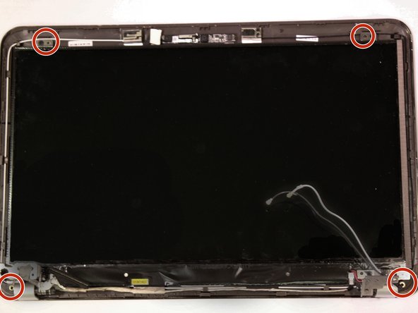

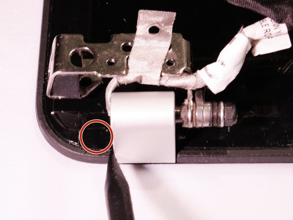

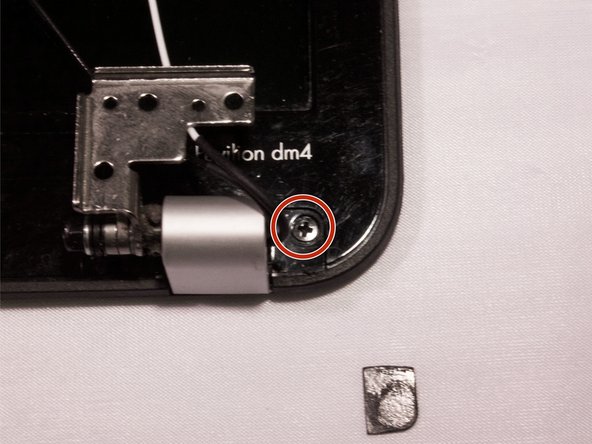

  14. HP Pavillion dm4t-2100 Screen Replacement: crwdns2935265:014crwdnd2935265:01crwdnd2935265:03crwdne2935265:0 HP Pavillion dm4t-2100 Screen Replacement: crwdns2935265:014crwdnd2935265:02crwdnd2935265:03crwdne2935265:0 HP Pavillion dm4t-2100 Screen Replacement: crwdns2935265:014crwdnd2935265:03crwdnd2935265:03crwdne2935265:0
    • Completely disconnect the screen.
    • Remove each plastic piece (2) covering the screws located next to the metal joint that's connecting the screen to the device.
    • Remove two 5mm Phillips #1 screws
  15. HP Pavillion dm4t-2100 Screen Replacement: crwdns2935265:015crwdnd2935265:01crwdnd2935265:02crwdne2935265:0 HP Pavillion dm4t-2100 Screen Replacement: crwdns2935265:015crwdnd2935265:02crwdnd2935265:02crwdne2935265:0
    • Gently flex the inside edge of the top, sides and bottom of the display until the bezel disengages.
    • Remove two 3.5mm Phillips #1 screws and two 2.5mm Phillips #1 screws.
    • Disconnect the panel cable along the bottom.
    • Now, the screen panel can be removed.
