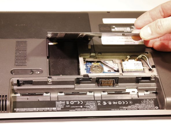

  3. HP Pavillion dm4t-2100 Memory Card Replacement, Memory Card: crwdns2935265:03crwdnd2935265:01crwdnd2935265:02crwdne2935265:0 HP Pavillion dm4t-2100 Memory Card Replacement, Memory Card: crwdns2935265:03crwdnd2935265:02crwdnd2935265:02crwdne2935265:0
    • Loosen two 5mm Phillips #1 screws securing plastic cover, until cover is detachable.
    • Slide cover toward empty battery area and remove it.

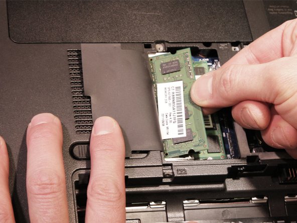

  4. HP Pavillion dm4t-2100 Memory Card Replacement: crwdns2935265:04crwdnd2935265:01crwdnd2935265:02crwdne2935265:0 HP Pavillion dm4t-2100 Memory Card Replacement: crwdns2935265:04crwdnd2935265:02crwdnd2935265:02crwdne2935265:0
    • Lift black cover overlaying memory chip.
    • Spread the tabs on each side of the memory slot to release the module.
    • Remove memory by pulling the memory out at an angle, until completely detached.
