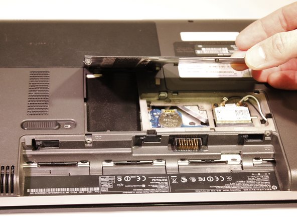

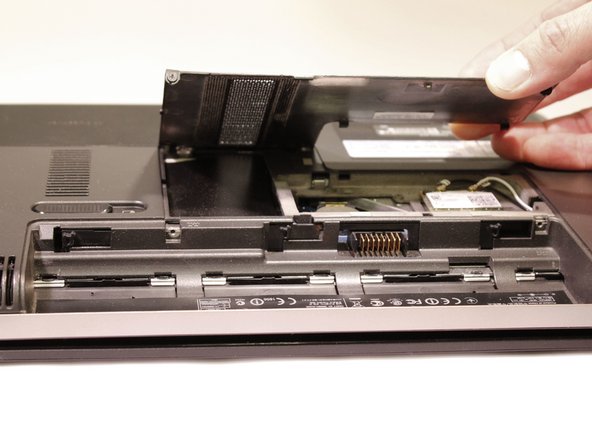

  3. HP Pavillion dm4t-2100 Hard Drive, Hard Drive: crwdns2935265:03crwdnd2935265:01crwdnd2935265:03crwdne2935265:0 HP Pavillion dm4t-2100 Hard Drive, Hard Drive: crwdns2935265:03crwdnd2935265:02crwdnd2935265:03crwdne2935265:0 HP Pavillion dm4t-2100 Hard Drive, Hard Drive: crwdns2935265:03crwdnd2935265:03crwdnd2935265:03crwdne2935265:0
    • Position the computer so the front is towards you.
    • Remove two 5mm Phillips #1 screws
    • Slide the hard drive cover towards the empty battery spot and remove it.

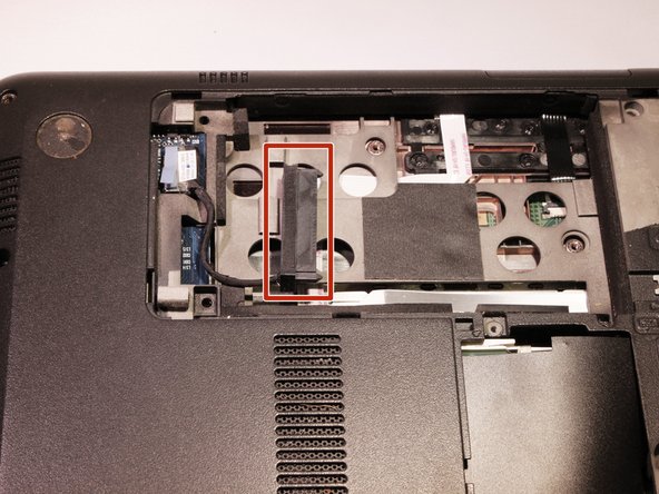

  4. HP Pavillion dm4t-2100 Hard Drive: crwdns2935265:04crwdnd2935265:01crwdnd2935265:03crwdne2935265:0 HP Pavillion dm4t-2100 Hard Drive: crwdns2935265:04crwdnd2935265:02crwdnd2935265:03crwdne2935265:0 HP Pavillion dm4t-2100 Hard Drive: crwdns2935265:04crwdnd2935265:03crwdnd2935265:03crwdne2935265:0
    • Loosen two 5mm Phillips #1 screws securing plastic cover, until cover is detachable.
    • Slide cover toward empty battery area and remove it.

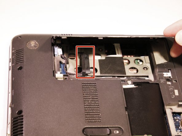

  5. HP Pavillion dm4t-2100 Hard Drive: crwdns2935265:05crwdnd2935265:01crwdnd2935265:01crwdne2935265:0
    • Disconnect the hard drive cable that is plugged in.
    • Lift the tab on the hard drive to pull it out of the computer.
    • Hard Drive is removed.
