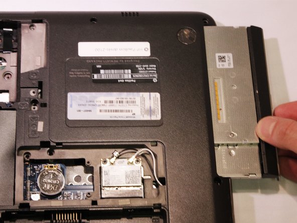

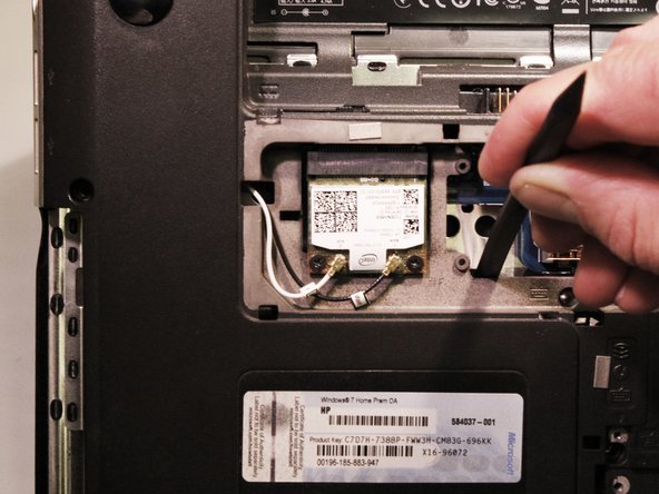

  6. HP Pavillion dm4t-2100 Finger Print Scanner Replacement, Finger Print Scanner: crwdns2935265:06crwdnd2935265:01crwdnd2935265:03crwdne2935265:0 HP Pavillion dm4t-2100 Finger Print Scanner Replacement, Finger Print Scanner: crwdns2935265:06crwdnd2935265:02crwdnd2935265:03crwdne2935265:0 HP Pavillion dm4t-2100 Finger Print Scanner Replacement, Finger Print Scanner: crwdns2935265:06crwdnd2935265:03crwdnd2935265:03crwdne2935265:0
    • Remove one 5mm Phillips #1 Screw that is securing the optical drive.
    • With the nylon spudger push the optical drive until you can grab it.
    • Pull the optical drive all the way out, until removed.

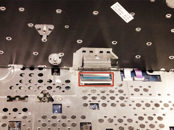

    • Turn the computer over, and open the computer as far as possible without breaking it.
    • Release the top of the keyboard by lifting up and gently pull the top up until the whole keyboard is up.
    • Lift plastic cover to release the ZIF connector that is holding the keyboard in place. Then remove the keyboard.

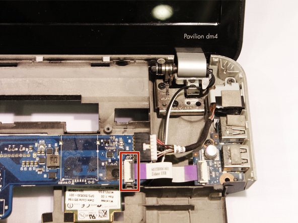

  11. HP Pavillion dm4t-2100 Finger Print Scanner Replacement: crwdns2935265:011crwdnd2935265:01crwdnd2935265:01crwdne2935265:0
    • Release 2 ZIF connectors where the touch pad cable and fingerprint reader are connected.
