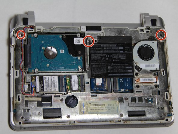

  4. HP Pavillion dm1-3010nr Keyboard Replacement: crwdns2935265:04crwdnd2935265:01crwdnd2935265:02crwdne2935265:0 HP Pavillion dm1-3010nr Keyboard Replacement: crwdns2935265:04crwdnd2935265:02crwdnd2935265:02crwdne2935265:0
    • Use the Phillips #0 screwdriver to remove three 5mm screws securing the keyboard.
    • The screws to be removed are circled in red in the picture provided.
    • Make sure to place the screws somewhere safe like on top of a magnet.

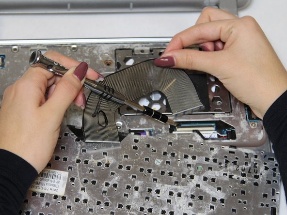

  6. HP Pavillion dm1-3010nr Keyboard Replacement: crwdns2935265:06crwdnd2935265:01crwdnd2935265:02crwdne2935265:0 HP Pavillion dm1-3010nr Keyboard Replacement: crwdns2935265:06crwdnd2935265:02crwdnd2935265:02crwdne2935265:0
    • Now you will see the keyboard cable connector attached to a locking tab.
    • Lift up the locking tab with a thin and flat screwdriver or your fingernail.
    • The locking tab will open up at a 90 degree angle.
    • Pull the keyboard cable from the connector.
