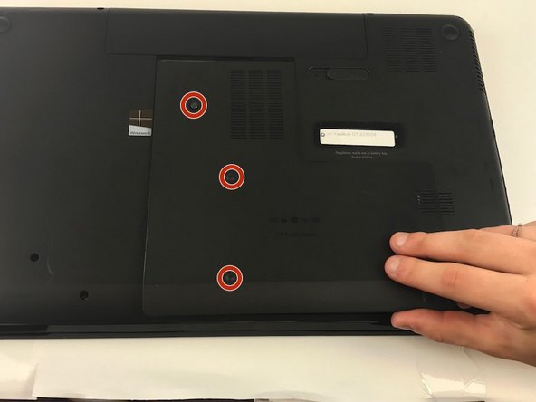

  3. HP Pavillion G7-2235DX Keyboard Replacement: crwdns2935265:03crwdnd2935265:01crwdnd2935265:02crwdne2935265:0 HP Pavillion G7-2235DX Keyboard Replacement: crwdns2935265:03crwdnd2935265:02crwdnd2935265:02crwdne2935265:0
    • Using a PH Screwdriver, remove the three 7.25mm screws located on the bottom panel.
    • After removing all screws, remove the panel by sliding down.

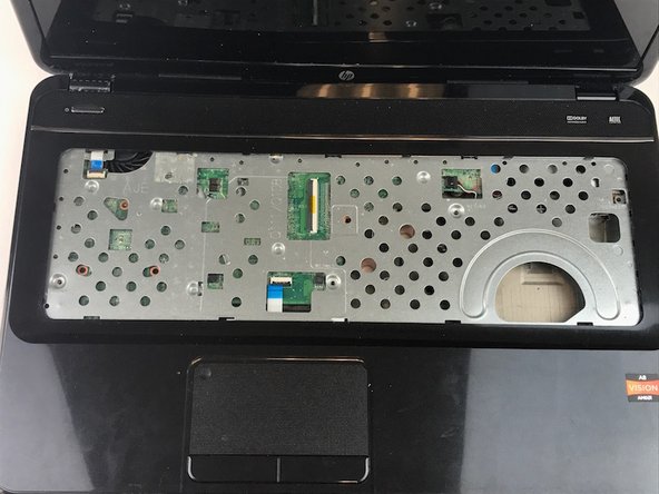

  5. HP Pavillion G7-2235DX Keyboard Replacement: crwdns2935265:05crwdnd2935265:01crwdnd2935265:01crwdne2935265:0
    • Flip the laptop over, and open it.
  6. HP Pavillion G7-2235DX Keyboard Replacement: crwdns2935265:06crwdnd2935265:01crwdnd2935265:01crwdne2935265:0
    • Using a plastic spudger, pry beneath the keyboard near the "delete" key, and pop the keyboard up from the laptop.
    • From the open gap, continue to pry around the perimeter of the keyboard, separating it from the laptop.
  7. HP Pavillion G7-2235DX Keyboard Replacement: crwdns2935265:07crwdnd2935265:01crwdnd2935265:02crwdne2935265:0 HP Pavillion G7-2235DX Keyboard Replacement: crwdns2935265:07crwdnd2935265:02crwdnd2935265:02crwdne2935265:0
    • Using both hands, carefully lift the keyboard off of the laptop.
    • There may be a ribbon attached. If so, gently pull the ribbon cable up and away from the connector.
