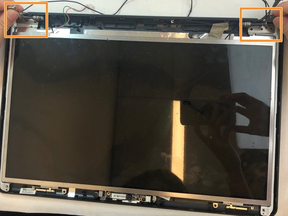

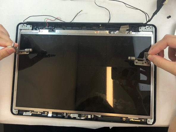

  19. HP Pavillion G60-120US LCD Screen Replacement: crwdns2935265:019crwdnd2935265:01crwdnd2935265:03crwdne2935265:0 HP Pavillion G60-120US LCD Screen Replacement: crwdns2935265:019crwdnd2935265:02crwdnd2935265:03crwdne2935265:0 HP Pavillion G60-120US LCD Screen Replacement: crwdns2935265:019crwdnd2935265:03crwdnd2935265:03crwdne2935265:0
    • Using the Phillips #0 screwdriver, remove the four 4.0 mm screws on both hinges of the laptop's screen.
  20. HP Pavillion G60-120US LCD Screen Replacement: crwdns2935265:020crwdnd2935265:01crwdnd2935265:02crwdne2935265:0 HP Pavillion G60-120US LCD Screen Replacement: crwdns2935265:020crwdnd2935265:02crwdnd2935265:02crwdne2935265:0
    • Gently lift and detach the display assembly from the laptop’s base.

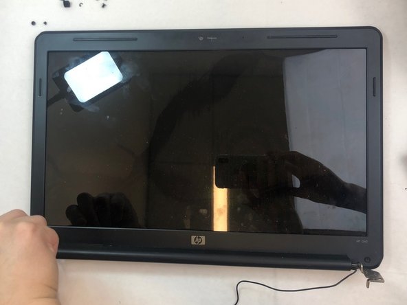

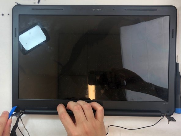

  21. HP Pavillion G60-120US LCD Screen Replacement, LCD Screen: crwdns2935265:021crwdnd2935265:01crwdnd2935265:03crwdne2935265:0 HP Pavillion G60-120US LCD Screen Replacement, LCD Screen: crwdns2935265:021crwdnd2935265:02crwdnd2935265:03crwdne2935265:0 HP Pavillion G60-120US LCD Screen Replacement, LCD Screen: crwdns2935265:021crwdnd2935265:03crwdnd2935265:03crwdne2935265:0

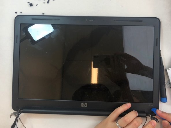

    • Using an opening tool, gently remove the two screw covers from the bottom corners of the screen.
  22. HP Pavillion G60-120US LCD Screen Replacement: crwdns2935265:022crwdnd2935265:01crwdnd2935265:02crwdne2935265:0 HP Pavillion G60-120US LCD Screen Replacement: crwdns2935265:022crwdnd2935265:02crwdnd2935265:02crwdne2935265:0
    • Using the Phillips #0 screwdriver, remove two 4.0mm screws from the LCD screen cover.

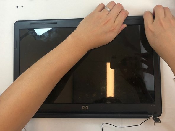

  23. HP Pavillion G60-120US LCD Screen Replacement: crwdns2935265:023crwdnd2935265:01crwdnd2935265:02crwdne2935265:0 HP Pavillion G60-120US LCD Screen Replacement: crwdns2935265:023crwdnd2935265:02crwdnd2935265:02crwdne2935265:0
    • Using an opening tool, gently lift the LCD screen cover and remove the cover.
    • Make sure not to use excessive pressure when detaching and removing the screen cover.

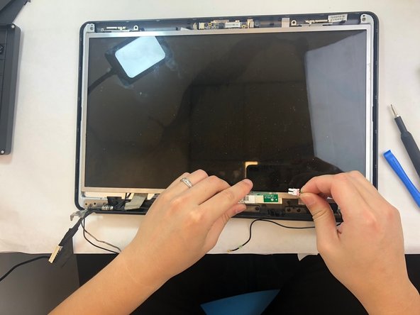

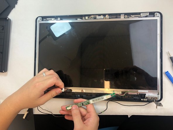

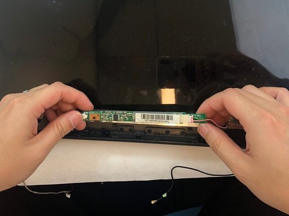

  24. HP Pavillion G60-120US LCD Screen Replacement: crwdns2935265:024crwdnd2935265:01crwdnd2935265:03crwdne2935265:0 HP Pavillion G60-120US LCD Screen Replacement: crwdns2935265:024crwdnd2935265:02crwdnd2935265:03crwdne2935265:0 HP Pavillion G60-120US LCD Screen Replacement: crwdns2935265:024crwdnd2935265:03crwdnd2935265:03crwdne2935265:0
    • Using your hand, grab the ends of the LCD chip and gently pull it out to detach it from the screen compartment.
    • Be careful not to break the chip when pulling it out.

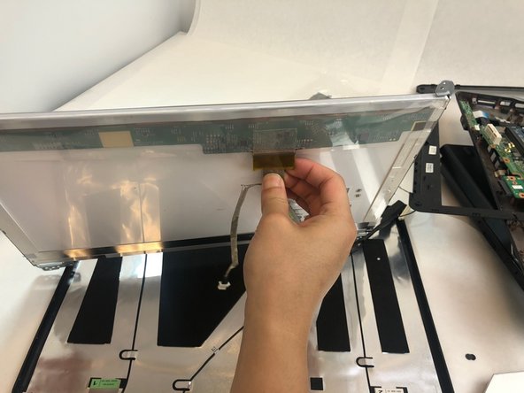

  25. HP Pavillion G60-120US LCD Screen Replacement: crwdns2935265:025crwdnd2935265:01crwdnd2935265:03crwdne2935265:0 HP Pavillion G60-120US LCD Screen Replacement: crwdns2935265:025crwdnd2935265:02crwdnd2935265:03crwdne2935265:0 HP Pavillion G60-120US LCD Screen Replacement: crwdns2935265:025crwdnd2935265:03crwdnd2935265:03crwdne2935265:0
    • Disconnect the two screen cables from the LCD chip.
  26. HP Pavillion G60-120US LCD Screen Replacement: crwdns2935265:026crwdnd2935265:01crwdnd2935265:03crwdne2935265:0 HP Pavillion G60-120US LCD Screen Replacement: crwdns2935265:026crwdnd2935265:02crwdnd2935265:03crwdne2935265:0 HP Pavillion G60-120US LCD Screen Replacement: crwdns2935265:026crwdnd2935265:03crwdnd2935265:03crwdne2935265:0
    • Using the Phillips #0 screwdriver, remove the six 4.0mm screws from the LCD screen holder.
    • Remove the two hinges on the bottom edge of the screen.

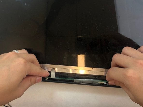

  27. HP Pavillion G60-120US LCD Screen Replacement: crwdns2935265:027crwdnd2935265:01crwdnd2935265:02crwdne2935265:0 HP Pavillion G60-120US LCD Screen Replacement: crwdns2935265:027crwdnd2935265:02crwdnd2935265:02crwdne2935265:0
    • Lift the screen and screen holder and remove the two cables that are connected to the screen.
    • Lift the plastic tape covering the wiring and gently pull on the wire to detach it.
    • Remove the screen holder and the LCD screen from the screen compartment of the laptop.

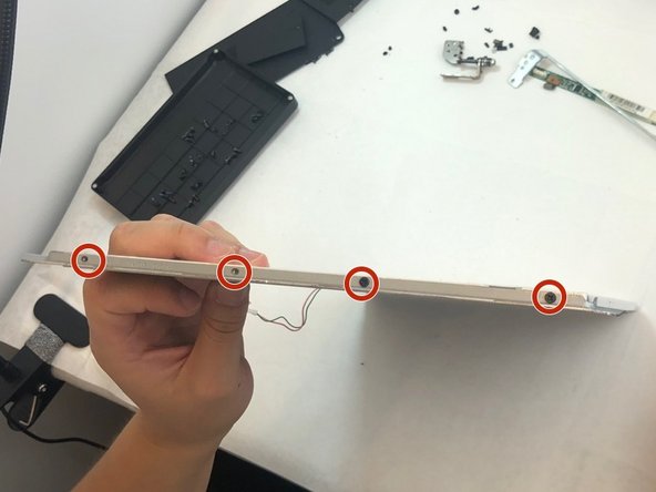

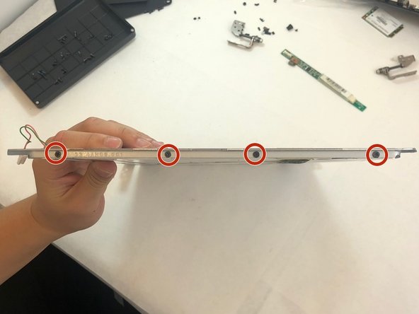

  28. HP Pavillion G60-120US LCD Screen Replacement: crwdns2935265:028crwdnd2935265:01crwdnd2935265:03crwdne2935265:0 HP Pavillion G60-120US LCD Screen Replacement: crwdns2935265:028crwdnd2935265:02crwdnd2935265:03crwdne2935265:0 HP Pavillion G60-120US LCD Screen Replacement: crwdns2935265:028crwdnd2935265:03crwdnd2935265:03crwdne2935265:0
    • Using the Phillips #0 screwdriver, remove the four 4.0mm screws on each side of the screen holder.
    • Detach and remove the screen holder from the screen.
