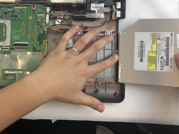

  23. HP Pavillion G60-120US Disc Drive Replacement, Disc Drive: crwdns2935265:023crwdnd2935265:01crwdnd2935265:02crwdne2935265:0 HP Pavillion G60-120US Disc Drive Replacement, Disc Drive: crwdns2935265:023crwdnd2935265:02crwdnd2935265:02crwdne2935265:0
    • Detach the disc drive from the motherboard by gently pushing it to the right.
    • Remove the disc drive from the laptop.
