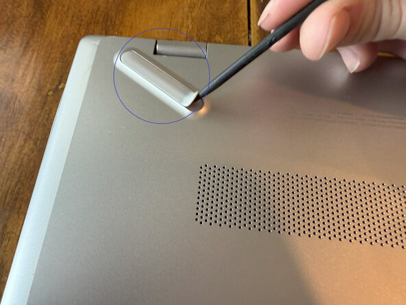

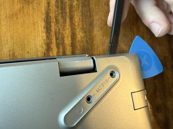

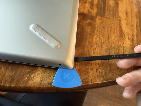

    • Starting at each front corner, insert a pry tool or spudger in between the case panels
    • Run the pry tool along the sides and front to release the clips
    • Do the same for the clips in between the hinges
    • These can be difficult, but I found success starting from the back corners and moving inwards, going one clip at a time
    • NOTE The clips may need some force to be pried open, but NEVER insert pry tools more than a few millimeters into the case or you risk damaging fragile components

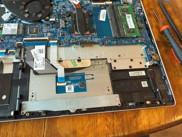

  4. HP Pavilion-15-cs3063cl Battery Replacement, Remove Back Panel, Locate Battery Screws: crwdns2935265:04crwdnd2935265:01crwdnd2935265:02crwdne2935265:0 HP Pavilion-15-cs3063cl Battery Replacement, Remove Back Panel, Locate Battery Screws: crwdns2935265:04crwdnd2935265:02crwdnd2935265:02crwdne2935265:0
    • Once all clamps have been released, firmly pull the back panel from the case using even force from both sides

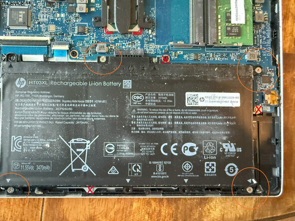

    • Locate the battery screws highlighted in Orange (4 total)
    • NOTE There are similar screws in proximity to the battery but we do not need to remove those for a battery replacement (marked by a red X)
  5. HP Pavilion-15-cs3063cl Battery Replacement, Unscrew Battery and Remove: crwdns2935265:05crwdnd2935265:01crwdnd2935265:02crwdne2935265:0 HP Pavilion-15-cs3063cl Battery Replacement, Unscrew Battery and Remove: crwdns2935265:05crwdnd2935265:02crwdnd2935265:02crwdne2935265:0
    • Once you remove the four retaining screws, gently lift up on the battery and slide it towards you to remove it from the case
    • NOTE When inserting new battery, ensure that the plastic holes align with the pegs near the bottom two screws
