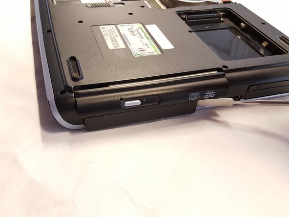

  23. HP Pavilion zv5000 Speaker Replacement: crwdns2935265:023crwdnd2935265:01crwdnd2935265:02crwdne2935265:0 HP Pavilion zv5000 Speaker Replacement: crwdns2935265:023crwdnd2935265:02crwdnd2935265:02crwdne2935265:0
    • Use the plastic spudger and insert it into the side of the CD drive and push outwards to pop the drive out of place.
    • If the plastic spudger does not pop the CD drive out, try carefully using the metal spudger.

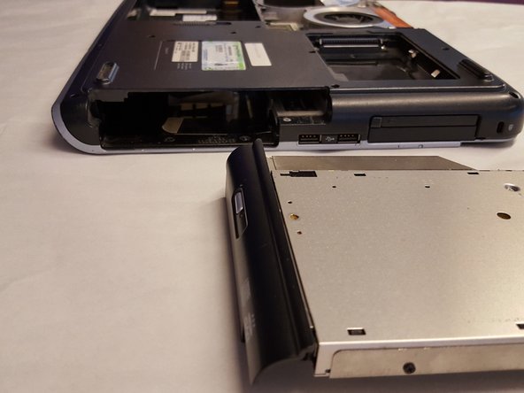

  24. HP Pavilion zv5000 Speaker Replacement: crwdns2935265:024crwdnd2935265:01crwdnd2935265:02crwdne2935265:0 HP Pavilion zv5000 Speaker Replacement: crwdns2935265:024crwdnd2935265:02crwdnd2935265:02crwdne2935265:0
    • Using your hands, firmly grasp the CD drive and pull outwards until it is completely removed.

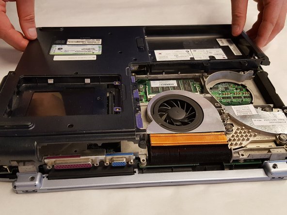

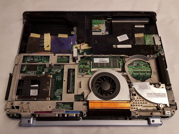

  26. HP Pavilion zv5000 Speaker Replacement: crwdns2935265:026crwdnd2935265:01crwdnd2935265:03crwdne2935265:0 HP Pavilion zv5000 Speaker Replacement: crwdns2935265:026crwdnd2935265:02crwdnd2935265:03crwdne2935265:0 HP Pavilion zv5000 Speaker Replacement: crwdns2935265:026crwdnd2935265:03crwdnd2935265:03crwdne2935265:0
    • Insert the plastic spudger into the edge of the base plate and the side of the laptop directly above the battery space and gently pry the base plate loose from its clips moving from right to left.
    • Once the clips are undone, lift the base plate up and off of the laptop.
    • If the plastic spudger is not sturdy enough to pop the clips out of place, carefully use the metal spudger.

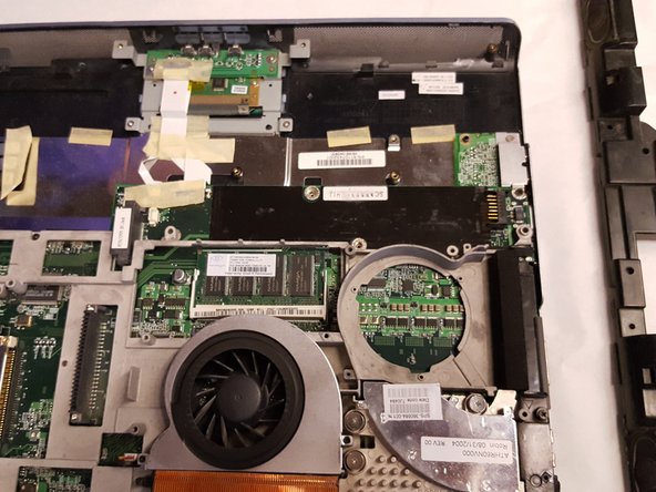

  27. HP Pavilion zv5000 Speaker Replacement: crwdns2935265:027crwdnd2935265:01crwdnd2935265:01crwdne2935265:0
    • Unscrew the one Phillip 2.5X6.0mm screw using the #0 Phillips again holding the speaker into place but do not remove speaker
  28. HP Pavilion zv5000 Speaker Replacement: crwdns2935265:028crwdnd2935265:01crwdnd2935265:02crwdne2935265:0 HP Pavilion zv5000 Speaker Replacement: crwdns2935265:028crwdnd2935265:02crwdnd2935265:02crwdne2935265:0
    • Using your fingers, firmly grasp the wires that connect the speaker to the board and gently pull the cable away from the connector in the same direction that the wires are running.
    • Apply even pulling force to all the wires so that no one wire is overly strained.
  29. HP Pavilion zv5000 Speaker Replacement: crwdns2935265:029crwdnd2935265:01crwdnd2935265:02crwdne2935265:0 HP Pavilion zv5000 Speaker Replacement: crwdns2935265:029crwdnd2935265:02crwdnd2935265:02crwdne2935265:0
    • Grasp speaker assembly firmly and pull towards you and up to remove the speaker completely from the laptop.
