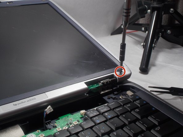

    • Remove two 5.0 mm Philips #0 screws on the hinge of the device

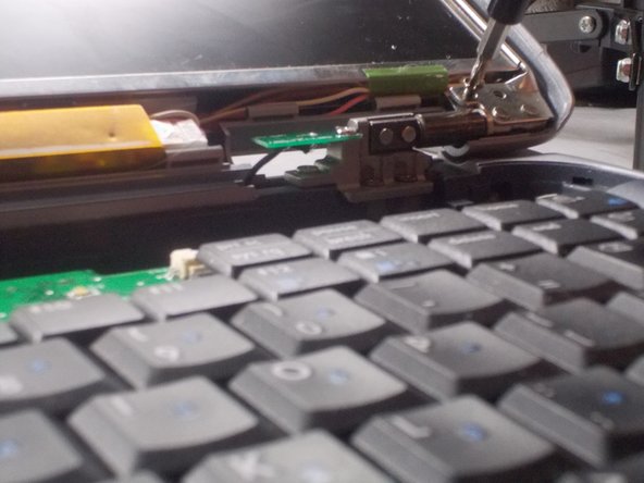

  2. HP Pavilion ze5000 Screen Replacement: crwdns2935265:02crwdnd2935265:01crwdnd2935265:02crwdne2935265:0 HP Pavilion ze5000 Screen Replacement: crwdns2935265:02crwdnd2935265:02crwdnd2935265:02crwdne2935265:0
    • Using tweezers, gently pull on the hinges to remove the plastic case connected to the hinges

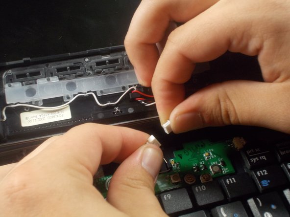

  3. HP Pavilion ze5000 Screen Replacement: crwdns2935265:03crwdnd2935265:01crwdnd2935265:03crwdne2935265:0 HP Pavilion ze5000 Screen Replacement: crwdns2935265:03crwdnd2935265:02crwdnd2935265:03crwdne2935265:0 HP Pavilion ze5000 Screen Replacement: crwdns2935265:03crwdnd2935265:03crwdnd2935265:03crwdne2935265:0

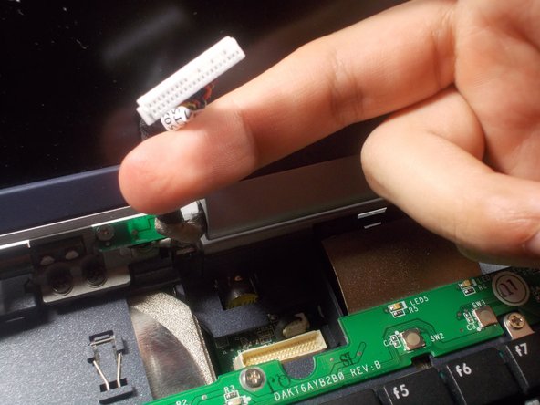

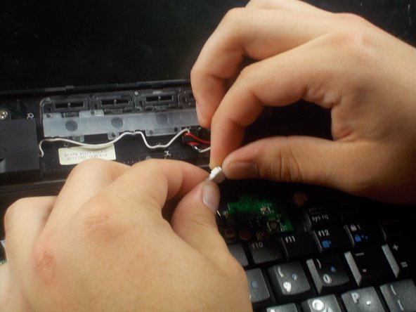

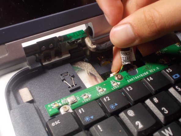

    • Remove the connection between the plastic case and interior of the device
  4. HP Pavilion ze5000 Screen Replacement: crwdns2935265:04crwdnd2935265:01crwdnd2935265:03crwdne2935265:0 HP Pavilion ze5000 Screen Replacement: crwdns2935265:04crwdnd2935265:02crwdnd2935265:03crwdne2935265:0 HP Pavilion ze5000 Screen Replacement: crwdns2935265:04crwdnd2935265:03crwdnd2935265:03crwdne2935265:0
    • Remove the connection from the exposed hinge and interior of the device

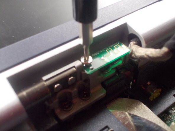

  5. HP Pavilion ze5000 Screen Replacement: crwdns2935265:05crwdnd2935265:01crwdnd2935265:02crwdne2935265:0 HP Pavilion ze5000 Screen Replacement: crwdns2935265:05crwdnd2935265:02crwdnd2935265:02crwdne2935265:0

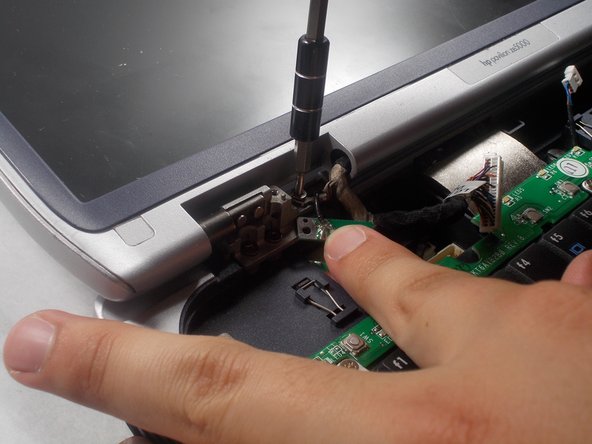

    • Remove the 3.5 mm philips #00 screw on the small circuit board on the hinge
  6. HP Pavilion ze5000 Screen Replacement: crwdns2935265:06crwdnd2935265:01crwdnd2935265:02crwdne2935265:0 HP Pavilion ze5000 Screen Replacement: crwdns2935265:06crwdnd2935265:02crwdnd2935265:02crwdne2935265:0
    • Remove the 5.0 mm philips #0 screw that was hidden underneath the small circuit board

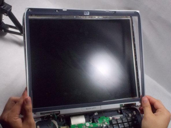

  8. HP Pavilion ze5000 Screen Replacement: crwdns2935265:08crwdnd2935265:01crwdnd2935265:03crwdne2935265:0 HP Pavilion ze5000 Screen Replacement: crwdns2935265:08crwdnd2935265:02crwdnd2935265:03crwdne2935265:0 HP Pavilion ze5000 Screen Replacement: crwdns2935265:08crwdnd2935265:03crwdnd2935265:03crwdne2935265:0
    • Unscrew the six 5.0 mm Philips #0 screws underneath the caps

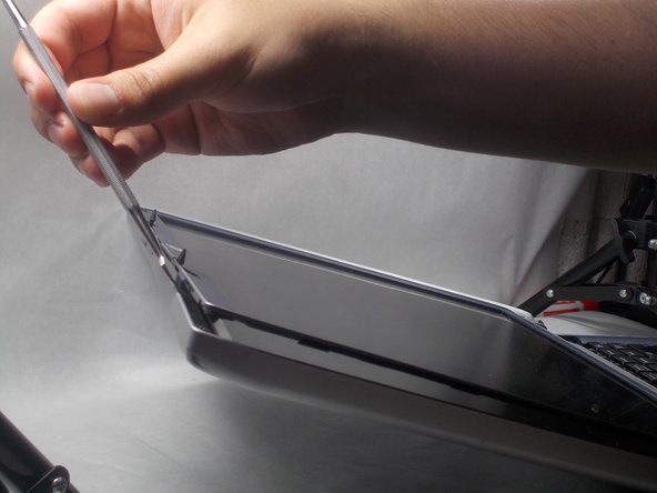

  9. HP Pavilion ze5000 Screen Replacement: crwdns2935265:09crwdnd2935265:01crwdnd2935265:03crwdne2935265:0 HP Pavilion ze5000 Screen Replacement: crwdns2935265:09crwdnd2935265:02crwdnd2935265:03crwdne2935265:0 HP Pavilion ze5000 Screen Replacement: crwdns2935265:09crwdnd2935265:03crwdnd2935265:03crwdne2935265:0
    • Using a spudger, pry the plastic casing off of the screen.

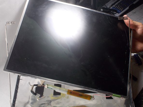

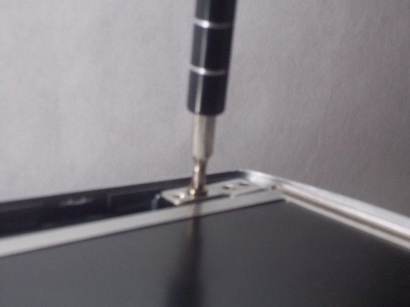

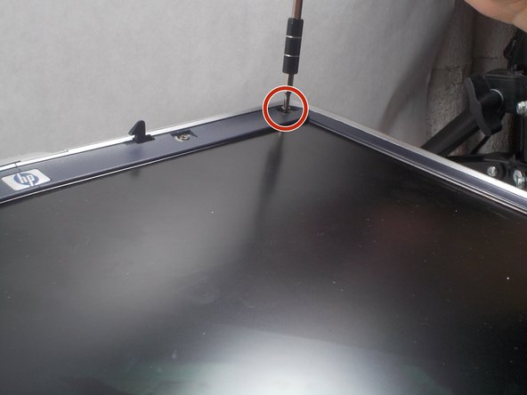

  10. HP Pavilion ze5000 Screen Replacement: crwdns2935265:010crwdnd2935265:01crwdnd2935265:03crwdne2935265:0 HP Pavilion ze5000 Screen Replacement: crwdns2935265:010crwdnd2935265:02crwdnd2935265:03crwdne2935265:0 HP Pavilion ze5000 Screen Replacement: crwdns2935265:010crwdnd2935265:03crwdnd2935265:03crwdne2935265:0
    • Remove four 5.0 mm Philips #0 screws located in the corners of the screen
    • These screws locations will be close to the screws locations in step 2.
    • During reassembly, make sure you do not confuse the proper screw placements from this step and step 4.
  11. HP Pavilion ze5000 Screen Replacement: crwdns2935265:011crwdnd2935265:01crwdnd2935265:02crwdne2935265:0 HP Pavilion ze5000 Screen Replacement: crwdns2935265:011crwdnd2935265:02crwdnd2935265:02crwdne2935265:0
    • Remove the four 3.5 mm Philips #00 screws from the sides of the aluminum casing.
    • There will be two 3.5 mm Philips screws on each side
