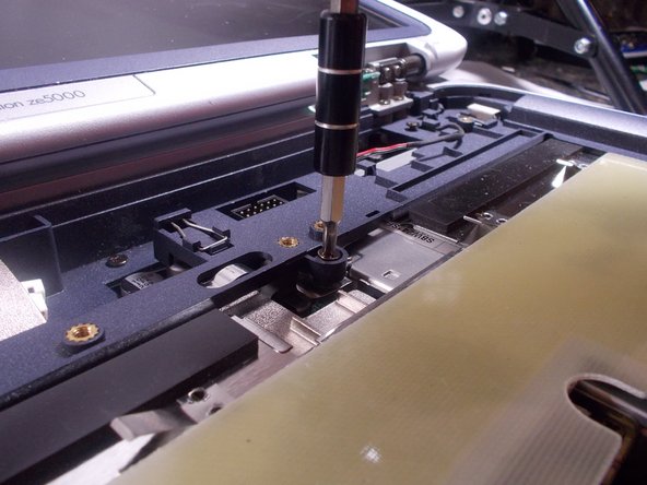

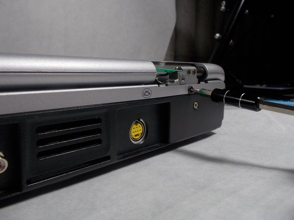

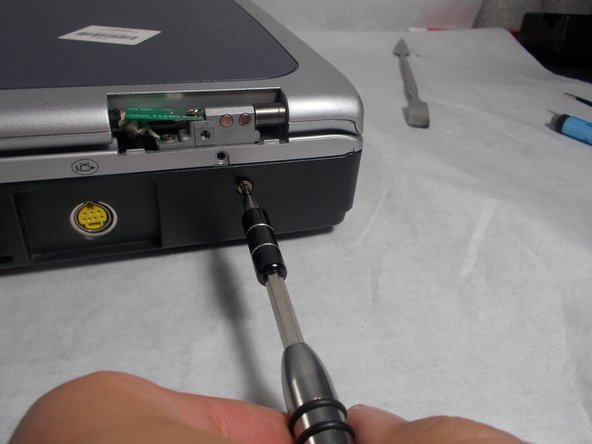

    • Remove the two 5mm Phillips #0 screws from the hinges
  4. HP Pavilion ze5000 Primary Fan Replacement: crwdns2935265:04crwdnd2935265:01crwdnd2935265:02crwdne2935265:0 HP Pavilion ze5000 Primary Fan Replacement: crwdns2935265:04crwdnd2935265:02crwdnd2935265:02crwdne2935265:0

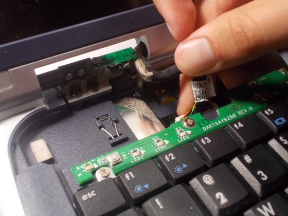

    • Remove the wire connection by gently pulling on the fuse and connection itself.
    • Do not pull on the wires, as this can remove the wires from the connection, destroying the fuse.

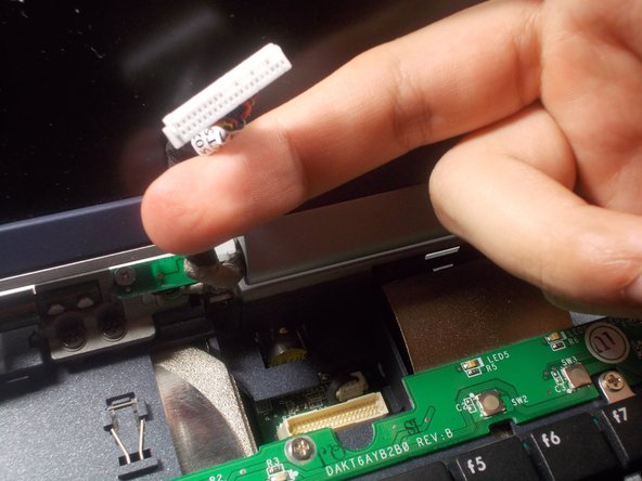

    • Gently lift the keyboard up from the frame so that you can see the ribbon still connected.
  8. HP Pavilion ze5000 Primary Fan Replacement: crwdns2935265:08crwdnd2935265:01crwdnd2935265:03crwdne2935265:0 HP Pavilion ze5000 Primary Fan Replacement: crwdns2935265:08crwdnd2935265:02crwdnd2935265:03crwdne2935265:0 HP Pavilion ze5000 Primary Fan Replacement: crwdns2935265:08crwdnd2935265:03crwdnd2935265:03crwdne2935265:0

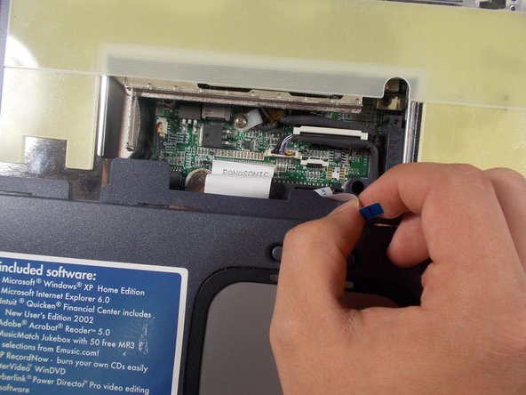

    • Remove the ribbon by gently pulling up the ends of the white receiver it is inserted in to.
    • You may need to use tweezers for this part.
    • During reassembly, when inserting the ribbon, you will hear a quiet, clicking sound when pushing down on the ends of the receiver. Hearing this ensures the ribbon is in place.

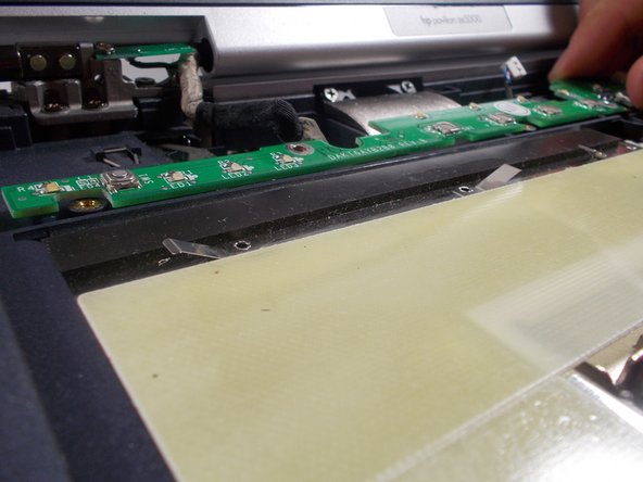

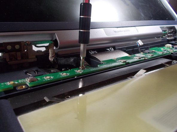

    • Remove the two 4.0 mm Phillips #0 screws attached to the cicuit board above the keyboard

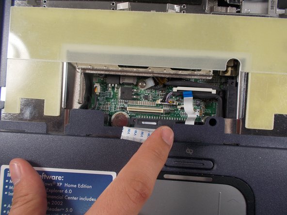

    • Disconnect the ribbons from the circuit board underneath the keyboard housing unit

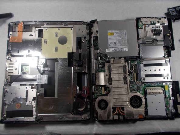

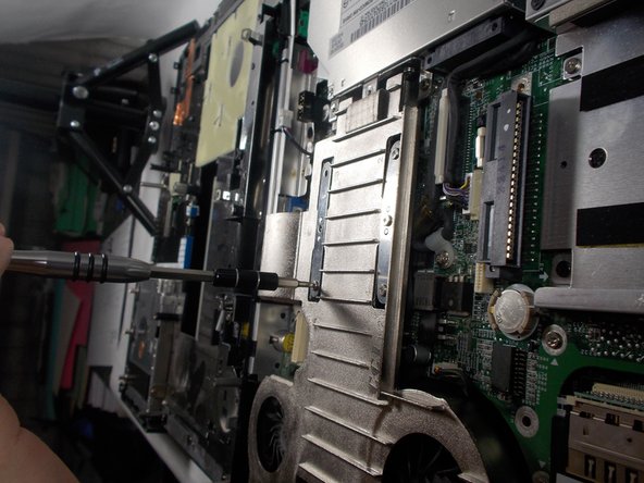

    • Pry the device apart to expose the inside of the device
    • This should be relatively easy since all connections and screws are removed. However, a spudger can be used if you are having difficulties.
  19. HP Pavilion ze5000 Primary Fan Replacement: crwdns2935265:019crwdnd2935265:01crwdnd2935265:03crwdne2935265:0 HP Pavilion ze5000 Primary Fan Replacement: crwdns2935265:019crwdnd2935265:02crwdnd2935265:03crwdne2935265:0 HP Pavilion ze5000 Primary Fan Replacement: crwdns2935265:019crwdnd2935265:03crwdnd2935265:03crwdne2935265:0

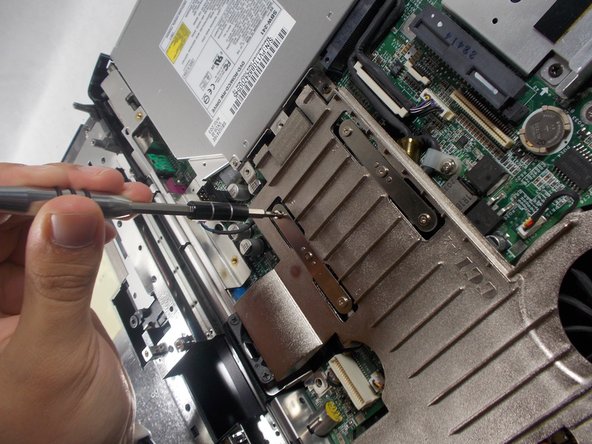

    • Remove the latches securing the fan housing unit by unscrewing the six 4.0 mm Phillips #0 screws

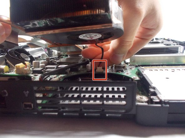

    • Lift the housing unit a few inches from the device to expose the two small connections.
  21. HP Pavilion ze5000 Primary Fan Replacement: crwdns2935265:021crwdnd2935265:01crwdnd2935265:02crwdne2935265:0 HP Pavilion ze5000 Primary Fan Replacement: crwdns2935265:021crwdnd2935265:02crwdnd2935265:02crwdne2935265:0
    • Remove the two small connections directly above and below the fan housing unit

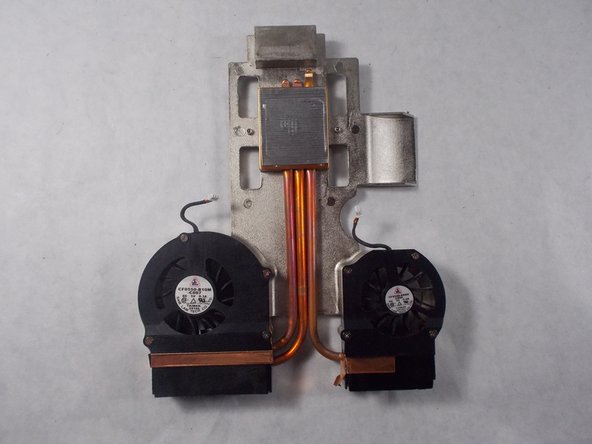

    • Remove the fan housing unit and flip it over

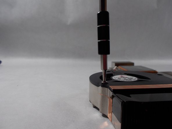

  23. HP Pavilion ze5000 Primary Fan Replacement: crwdns2935265:023crwdnd2935265:01crwdnd2935265:03crwdne2935265:0 HP Pavilion ze5000 Primary Fan Replacement: crwdns2935265:023crwdnd2935265:02crwdnd2935265:03crwdne2935265:0 HP Pavilion ze5000 Primary Fan Replacement: crwdns2935265:023crwdnd2935265:03crwdnd2935265:03crwdne2935265:0

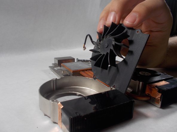

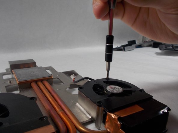

    • Remove the eight 3.5 mm Phillips #00 screws from the fan housing unit
  24. HP Pavilion ze5000 Primary Fan Replacement: crwdns2935265:024crwdnd2935265:01crwdnd2935265:02crwdne2935265:0 HP Pavilion ze5000 Primary Fan Replacement: crwdns2935265:024crwdnd2935265:02crwdnd2935265:02crwdne2935265:0
    • Remove both or whichever fan needs to be replaced
    • There should be bronze electric tape on the fan housing unit. Do not hesitate to tear the tape in order to open the housing unit
